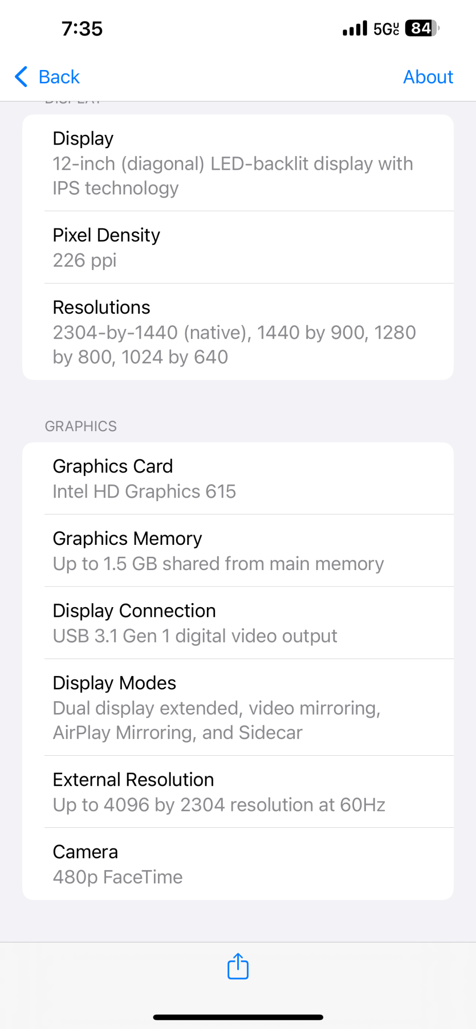

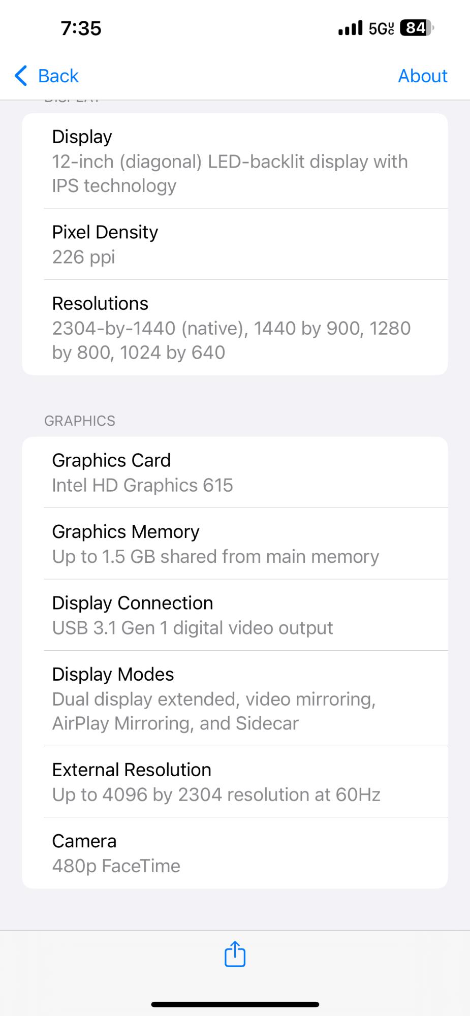

Some Mac’s only supported 30hz but this isn’t one of them. The 2017 MacBook supported 4k @ 60hz.
Photo right from Mactracker
