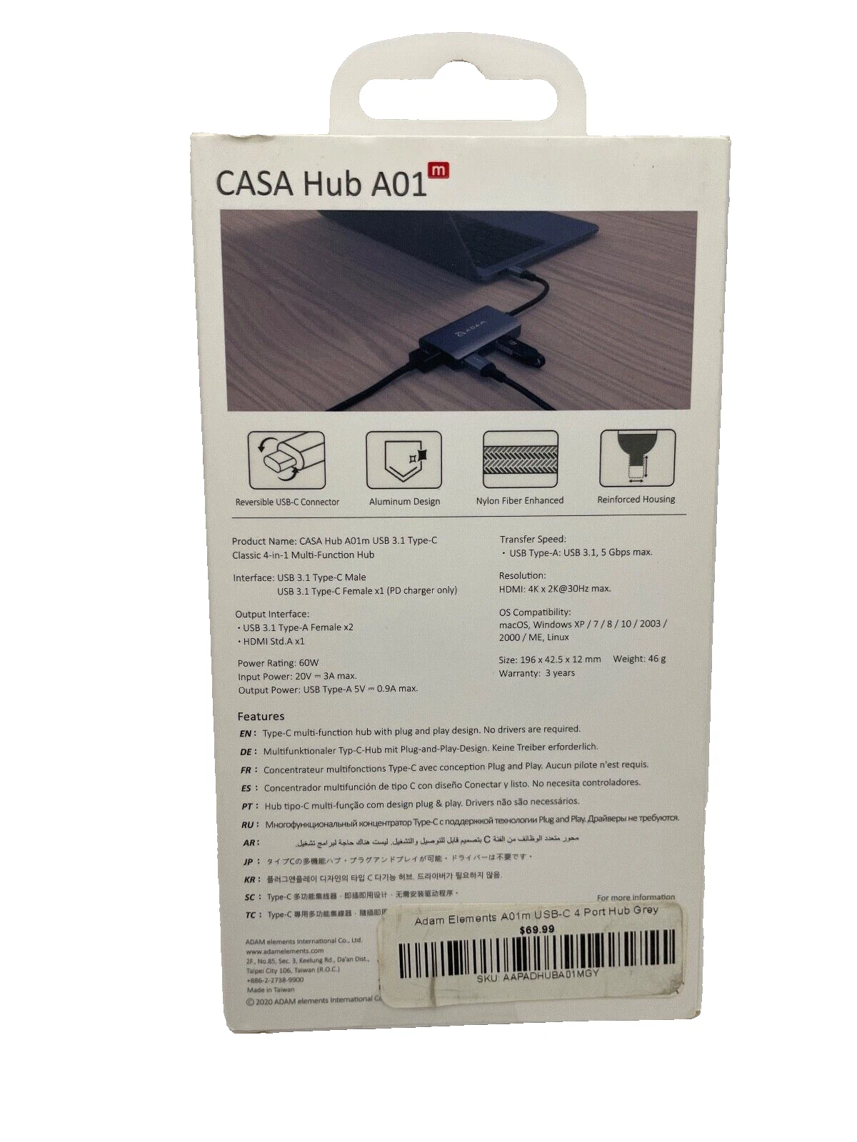

That hub only does 4K @ 30 Hz regardless it looks like (see here).

These are the choices for the MacBook (Retina, 12-inch, 2017):
1) USB-C hub supporting USB 3.x (1a) 4K30 (1b) 1440p60
2) USB-C hub supporting USB only up to USB 2.0 (2a) 4K60
Here's an example of a USB-C hub that supports USB only up to USB 2.0:
https://www.cablematters.com/Cable-Matters-USB-C.aspx
A 3rd option is no hub (4K60 like option #2) but this MacBook has only one USB-C port.

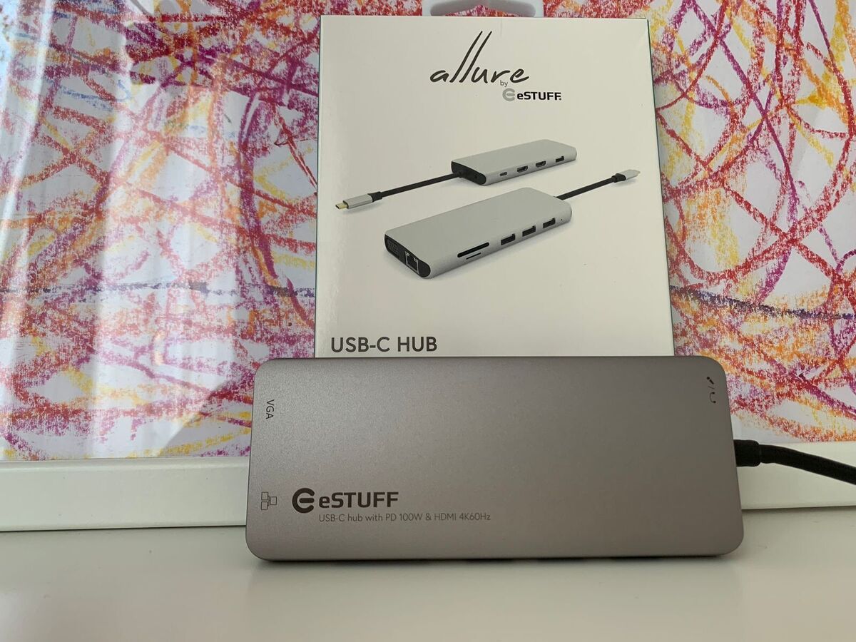

I thank you for the deep dive, but I'm afraid I've not the slightest about things like HBR or chroma subsampling. This further proves how unbelievably complicated Apple, Intel, and the standardising bodies responsible for all those specs make it for home users. The webpage you're referencing times out. Is this here what you're talking about, perchance? https://www.amazon.de/Cable-Matters-Multiport-Adapter-Ethernet-Schwarz/dp/B0746RM54Y
Also, UGreen claim their USB 3 enabled hubs can do 4K@60: https://eu.ugreen.com/de/products/45363
Even these guys do (right on da friggin' case): https://www.ebay.de/itm/127001055982
I already explained why no USB-C hub that supports USB 3.x can support 4K60 with your Mac unless the hub uses DisplayLink instead of USB-C DisplayPort Alt Mode or you find a way to reduce the bandwidth required for 4K60 such as by using a different OS like Windows that lets you choose color depth or chroma sub sampling options. Those options might not exist for Intel graphics in Windows? They are likely to exist for ATI or Nvidia graphics but that doesn't matter with this MacBook.
I also explained what is required from a Mac to output 4K60 using a USB-C hub that supports USB 3.x.
