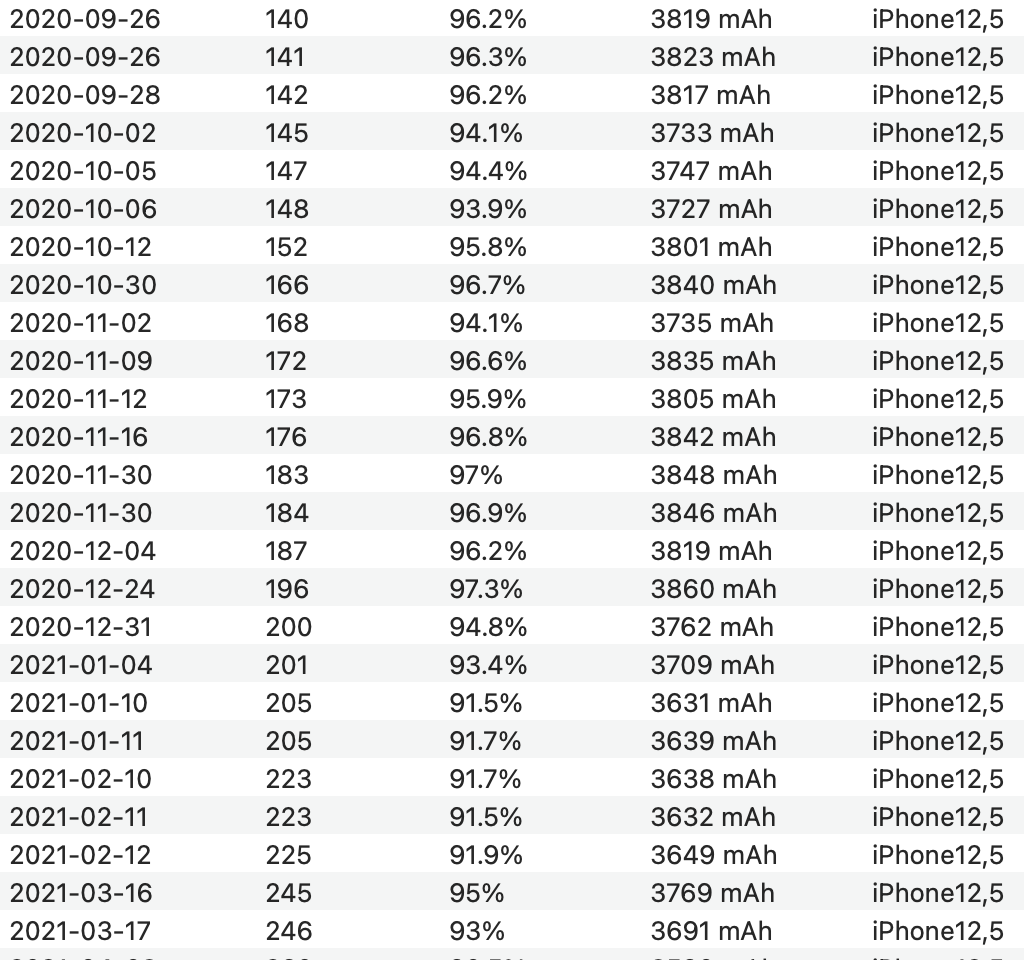

Battery health calculation is measured using various methods over its voltage storage range and averaged with itself. Averages and educated guesses are use to help mitigate external factors. For example if you battery is very cold its more difficult to extract energy from it, this would appear to the phone as a failing battery (high amps loads causing large dips in the voltage). Using data pulled from that time period won't represent actual battery health.
Like mentioned a few times, battery health degradation isn't linear. You're battery will generally rush to around 85% before its degradation drastically slows. This is because the max voltage the lithium battery stores is near its overcharged capacity which is difficult for the chemistry to maintain. Apple's "Optimized Battery Charging" feature stops battery charging around 80% until the time its closer to coming off the charger. This keeps the voltage further away from overcharged voltages to reduce stress induced on it.
Battery health indicators takes a few educated guesses and take a few liberties for the consumer to find the percentage less confusing. For example someone above mentioned their batteries are still at 100% after months. This is because their batteries max storage capacity was above Apples pre programmed mAh rating. So to be technically accurate they just can't see the degradation of their battery because its outside (above) Apples new battery mAh value. So it could have been 110% when they bought it and its 103% now meanwhile Apple is just showing them 100%. Unfortunately no battery is that resistant to degradation when you have its max storage voltage at an overcharged state. The reason their battery may have been 110% brand new and your's might have been 100% brand new is because of variances in manufacturing.
Battery health also varies depending on many external variables so it can never be accurately calculated as a "snap shot". Apple does not show these fluctuation and instead uses a larger sample size for its averaging, so the battery might be 90% this week and Apple reports 90% but next week its 93%. Apple will keep the health menu reading 90% which is artificially low. Here is Coconut Battery tracking my iPhone 11 Pro....
So those dates are in order and the battery health is trending down however its not as linear as Apples health percentage would lead you to believe. Just before I was at 200 cycles my batteries health was back to 97-98 percent. Today its 85% and next week it will be back up again.
Long story short, this is why many people say don't worry about it. Battery health is an educated guess and you really shouldn't concern yourself over guesses, even educated guesses. They will warranty it if there is a problem so my suggestion would be if you are going to worry about it wait until a month before the free battery replacement warranty is about to expire and then check it to see if its below 80%.
Good luck.
