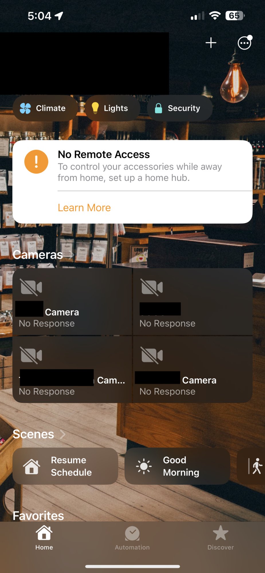

My smart home has been going nuts over the last two days. I keep getting flurries of hubs and accessories dropping off and then coming back. Sometimes none of the 6 available hubs are working and everything goes offline, and then it comes back but a door lock or some random accessory will drop off.
One of my HomePod Minis has been incredibly flakey. This morning it even got stuck when playing music like a scratched CD. I have had to reboot that thing multiple times a day as it keeps not responding.
As far as I am aware, nothing has changed or been updated. Anyone else getting this kind of behavior?
I was fighting something similar last weekend. I thought it was related to a power outage we had at our home, but maybe it was an iCloud thing after all. I finally fixed it by unplugging all my home hubs and leaving them all unplugged for about 20 minutes. I waited until the Home app said all my hubs were offline. Then, one by one, I plugged them back in. I waited a bit as each one came back online before plugging in the next. Everything has been running well since then with hardly any drops at all.
I’ve had the same issues for the last few days. Hubs randomly all going offline, then single devices dropping in and out of the network. I’ve been going crazy trying to troubleshoot and it’s driving my wife bonkers. I was one of the lucky few who successfully updated my home architecture after 16.2 was released but before Apple pulled the update.
