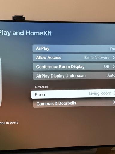

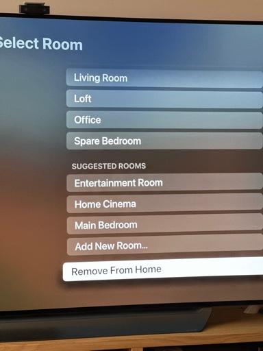

The option to remove/add as a HomeKit hub is there, at least on 16.3 beta on my Apple TV 4K 2022
That removes the Apple TV from Home entirely which means it can’t act as thread or Bluetooth router. There used to be an option to keep it in Home, but disable it as a hub. That option disappears after updating to the new architecture.
But if you removed it from the home on the older versions of tvOS the result would be the same as on the new version wouldn't it? IE it can't be used as any kind of hub (thread, HomeKit etc). Or am I missing something here?
Also, whether you "disable" on the standard architecture, or "remove from home" on the new architecture, either option probably also means they won't act as BTLE/Thread beacons any more.
IMHO they should, though. Maybe it's indicative of the general apathy/lack of effort that seems to permeate HomeKit. I don't want 19 hubs. I do want all capable devices to be beacons or relay BTLE/Thread when capable.
I'm kinda sad and a bit resentful that Apple thinks I should have 19 hubs. The day I have to "rebuild" my home from scratch and spend literally hours just adding all those hubs back (before I even get to all the accessories) I'm probably going to explore Home Assistant and see if that's a better option for me.

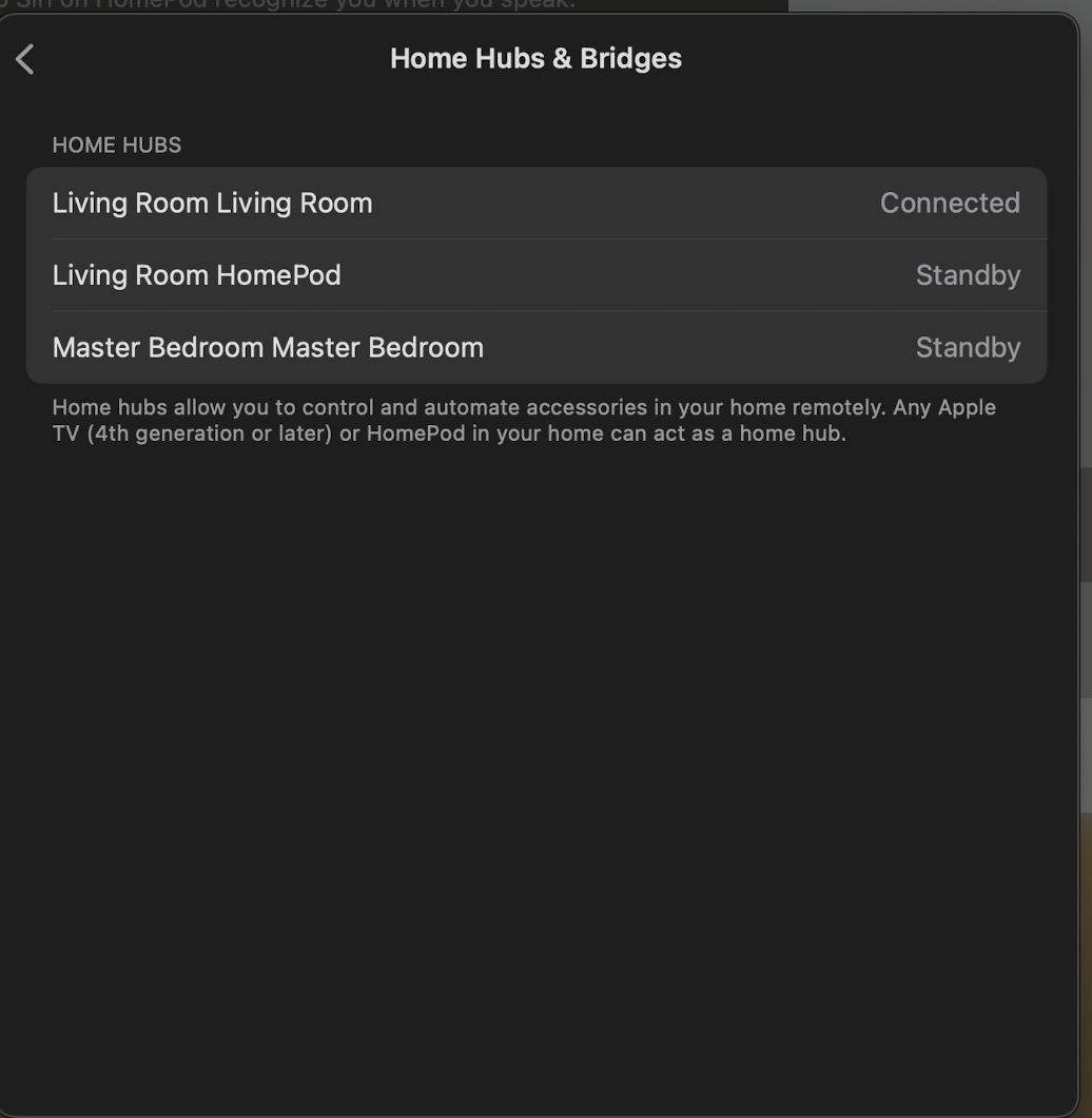

I upgraded to the new architecture before it was pulled. Everything remains attached to my smart home and my scenes still work, but none of my timed automations will run. Automations triggered by a sensor or other device still run properly, but the simple act of turning on lights at sunset is broken.
I have even tried creating the automations in Shortcuts, and that doesn't make any difference. 🤬

Today half my Home devices suddenly stopped responding. I had to reboot my router to get them back.

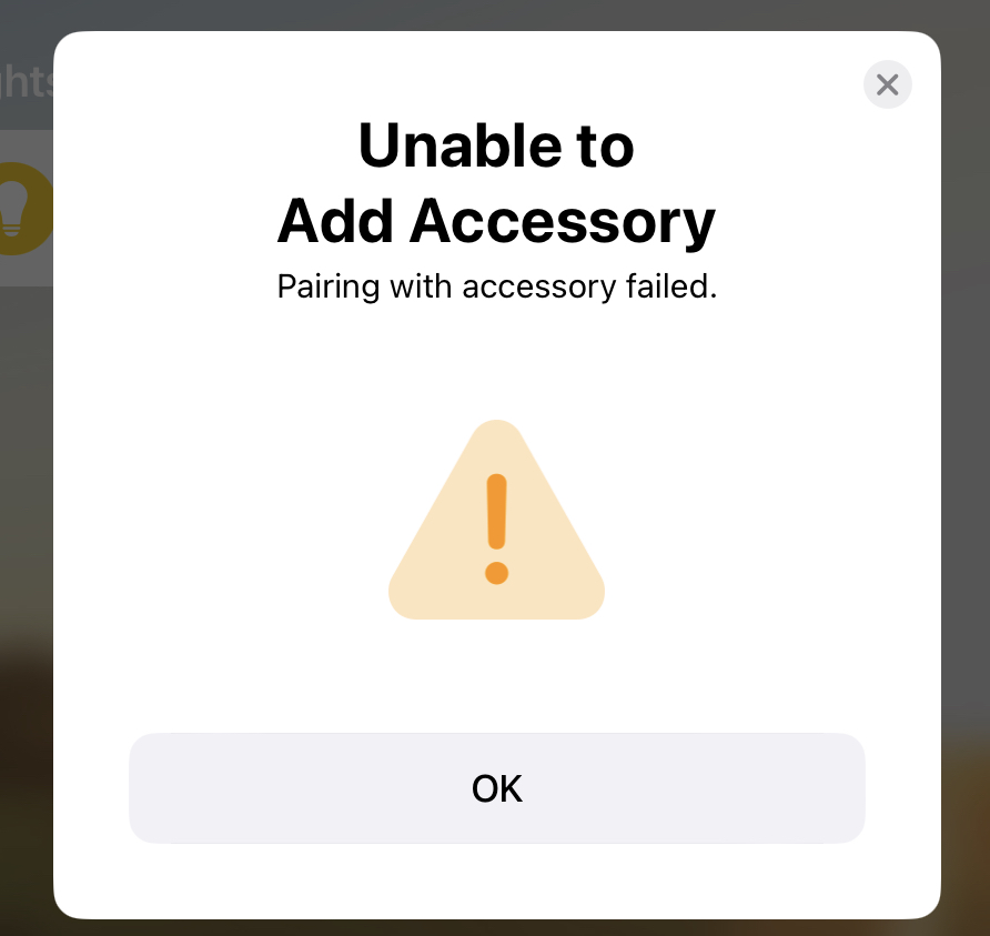

Now all my Door & Window sensors can currently no longer be added to my Home via add accessory after resetting them :sob-sob: hopefully there is an easy fix for this too!
Spot of good news, managed to re-join the sensors to Home after resetting the iPad! Eve also made a number of suggestions for re-pairing the Eve devices to the Home app:
1 Reset the accessory by holding down the LED button and waiting for ~10 seconds until it blinks red (for Eve Energy) or using the pinhole reset (for Eve Door&Window and Eve Motion), then try to re-add back;
2 Try adding manually by tapping More Options in the add accessory window on the iPhone and locating the accessory there (then using the manual setup code found on the generated Matter QR code);
3 Reboot the iPhone/iPad
4 Make sure the home hubs are all on 16.2
5 Make sure the iPhone/iPad is on the same Wi-Fi network as your home hub(s) and is not on a VPN connection
6 Some customers report that temporary turning off the 5 GHz wi-fi network on the router helped them
7 Try and see if there is your accessory listed in iPhone/iPad Settings under General -> Matter Accessories (next to CarPlay) — the option may not be there. If there is one, and it seems to be the one you cannot pair add to (check the serial number), then try Removing it there first.
Other observations for Eve Door & Window sensor; should the infamous "No Response" pop up then (in my experience) this may be early signs of battery depletion (around 80% or less), the sensors appear to be somewhat more responsive after the batteries were replaced. Not clear if replacing the battery is the long term fix or whether there are other underlying issues with the Thread / Matter network within the Apple ecosystem.
