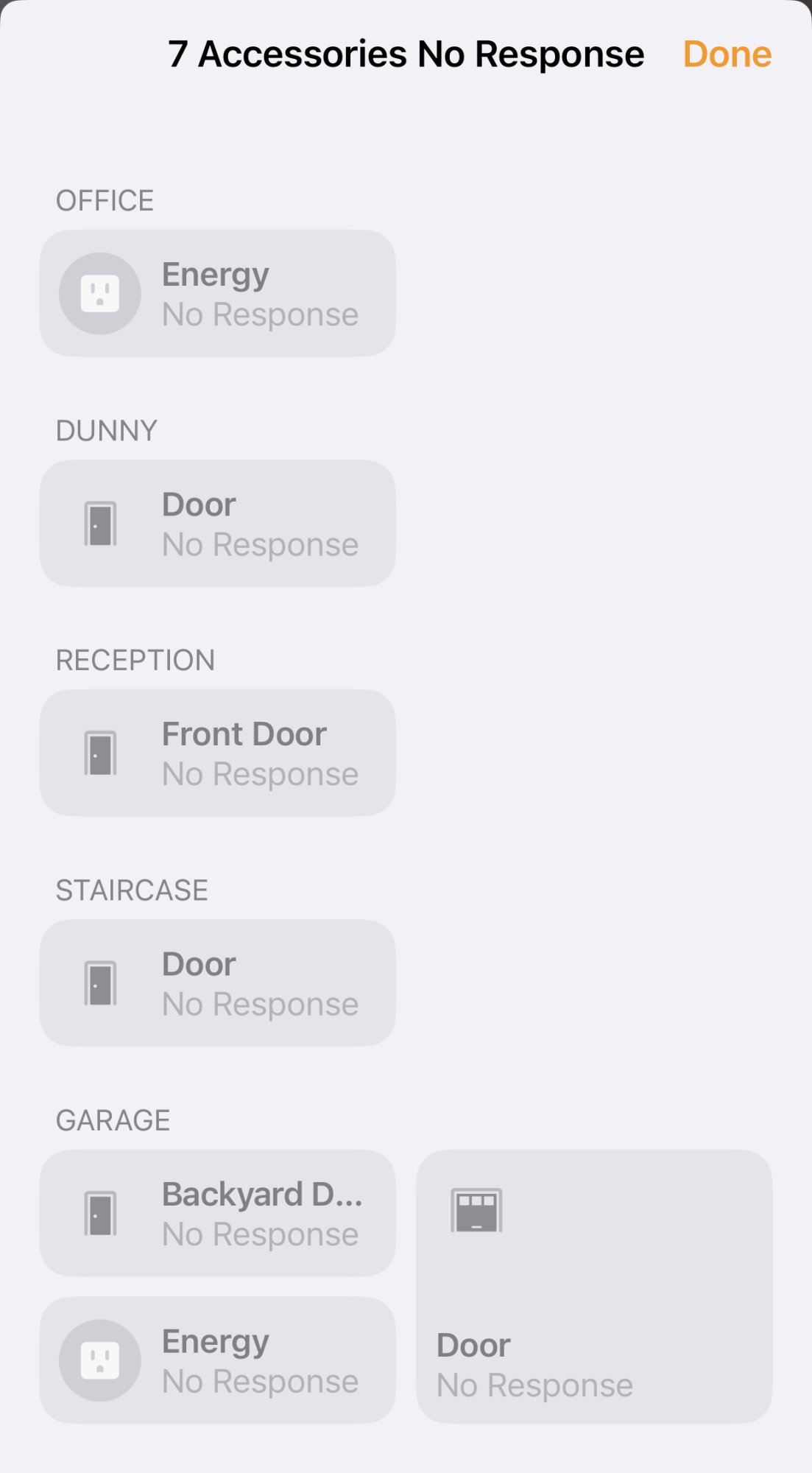

Is anyone able to confirm that 16.3 fixes the Matter connectivity issue(s) for Eve products (Energy / Door & Window Sensors)?
I am hoping that 16.3 fixes the issues I'm having (I updated to 16.2 and the new architecture before it was pulled). So far, though, it's not showing up as available for either my HomePods or Apple TVs.

Had high hopes for 16.3 to resolve the Eve Matter devices, now I am giving up...had enough of this nonsense!

Following Eve support engineers on the beta program, I removed the offending matter devices from HomeKit, reset them, and added them again using the matter codes. Two days and counting and all okay… So far.
I think I have found the culprit (at least at my end!)...it was the Apple TV (I think!)
My Homehub set up: 1 Apple TV 4K (1st Gen), 1 Apple TV 4K (2nd Gen) & 2 HomePod Minis. I have now disabled both Apple TV leaving the HomePod Minis as the HomeHub (for obvious reasons!), the Eve equipment running on Matter appear to be steady...
