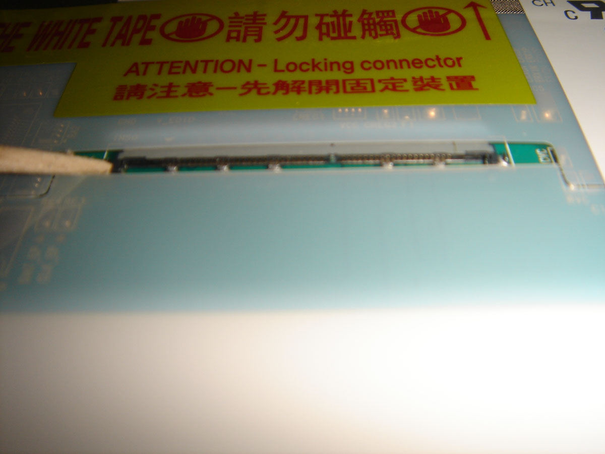

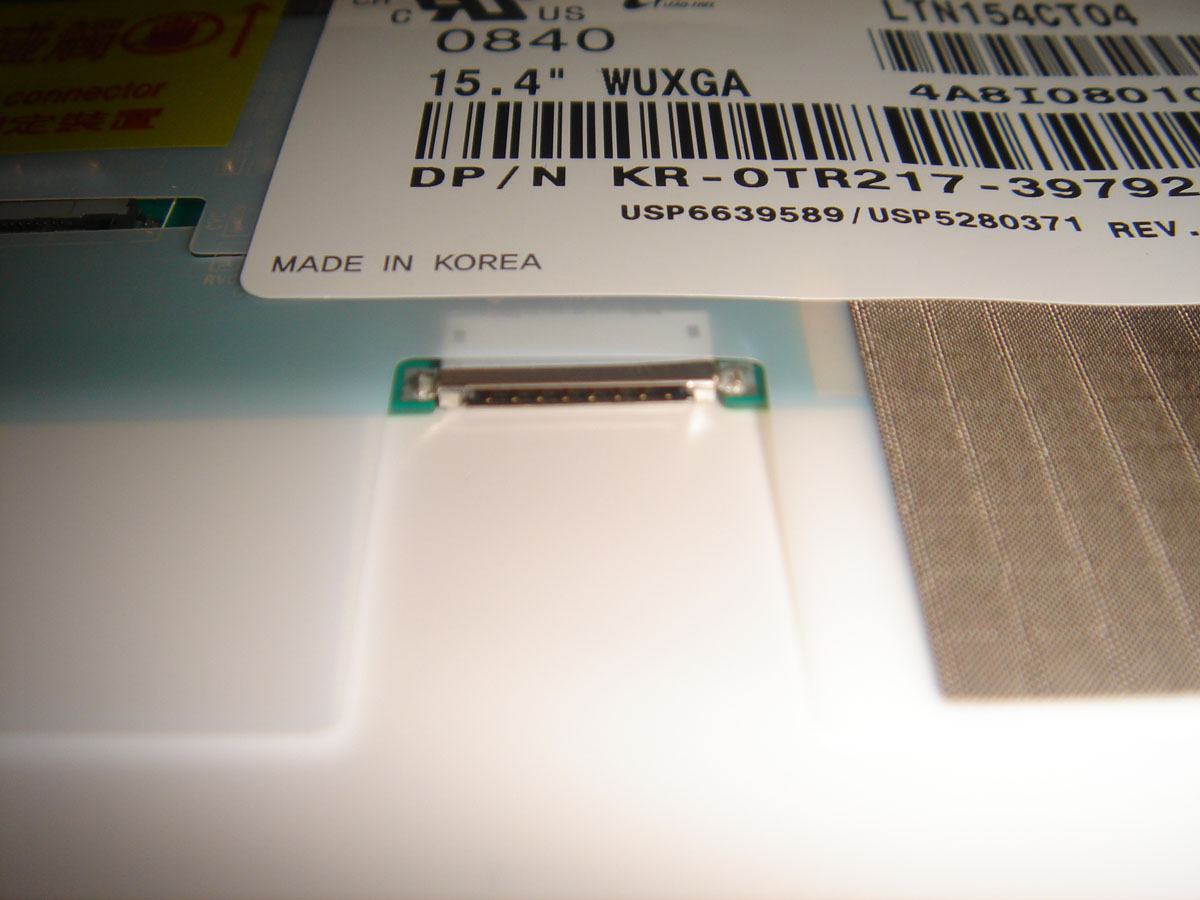

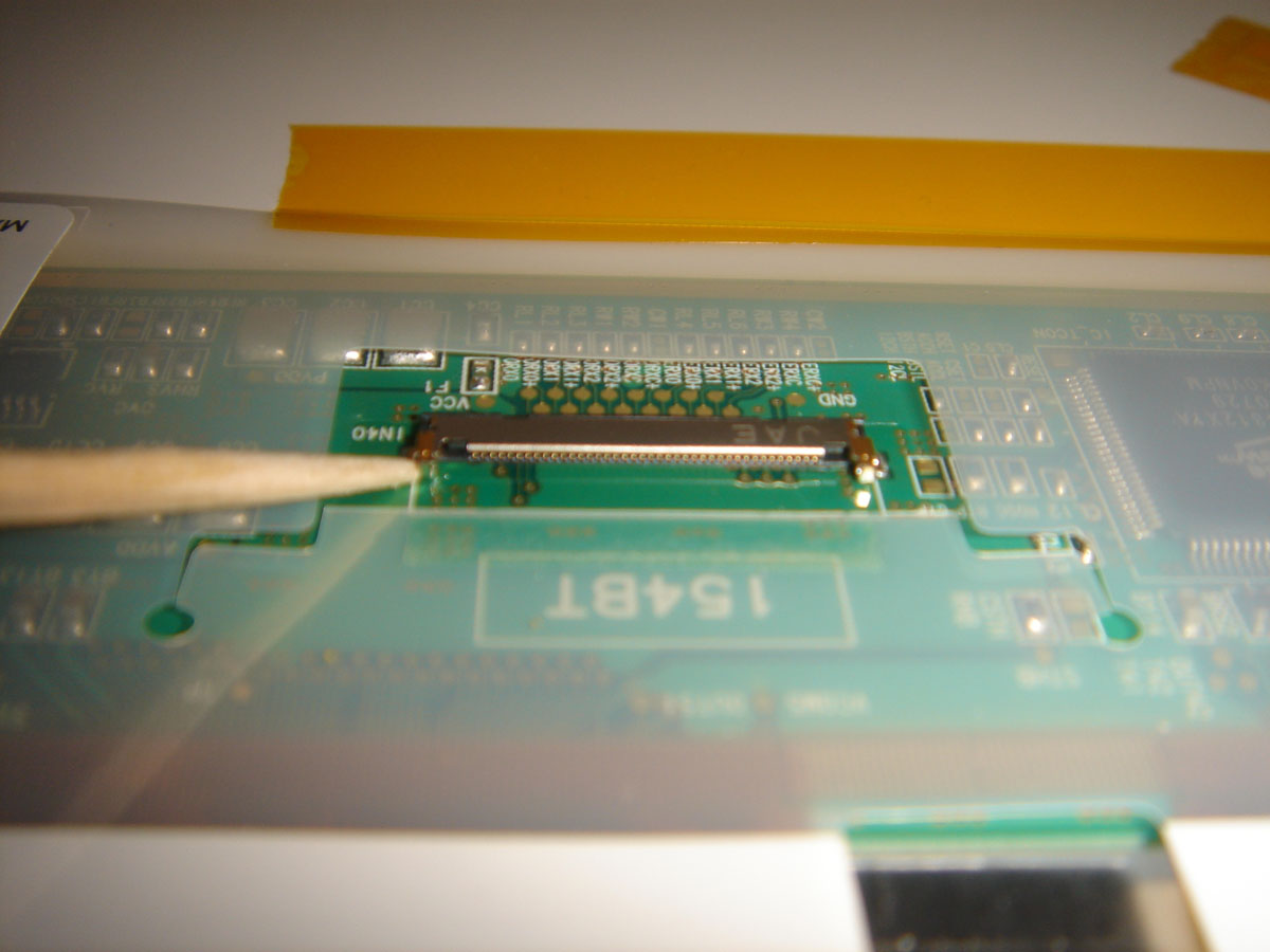

Okay, so I plonked down the dough to try it and the WUXGA screen for the Dell M4400 has completely different connectors on the back of the LCD and is slightly too large height-wise by just a couple of millimeters. :(
Looks like it goes back to fleaBay to try and recover some of my money.

Sure. Here goes. Obligatory disclaimer: I am not a good photographer. I tried reducing these, so if you need a larger pic or a clearer one, let me know. It was difficult to get the connector leads clear in the photos.
The first three are the new screen. The two plugs are of different size than the plug on the original screen in the forth pic. In the fifth, overlaying the two screens, I have drawn arrows indicating the direction the plug would insert, so the new screen is inverted in this regard. The bottom of the pic is also the bottom of the screens when in use.
Again, it is a couple of millimeters taller, so it still won't fit even if someone figures out the plugs. I guess I am putting the old one back together.
DS
