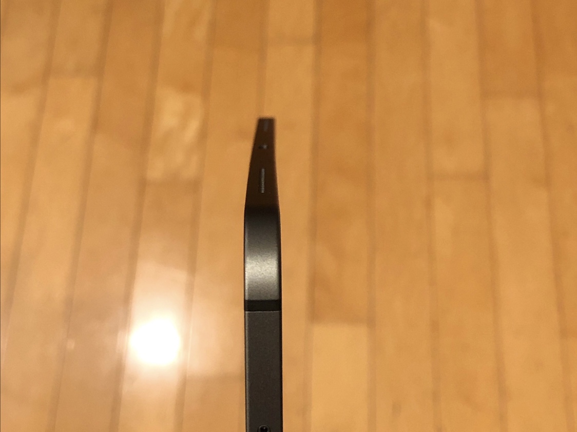

That photo looks like an iPad that's been bent on purpose. There's no gentle curve. There's a bend in the center, right where the thumbs go in every shot of someone bending one on purpose. Then he put It in the box to take the photo, so you guy would lose your minds.
They should’ve chosen a more representative photo. Here is a photo of my 12.9” cellular. It was like that out of the box.
It is slightly outside of Apple stated tolerance - I measured ~0.5-0.6 mm, but pretty obvious.
I also had 11” and went to get another 12.9”, and that one was also bent out of the box.
It is a real issue that affects mostly cellular models because of their plastic inserts...

[doublepost=1546877625][/doublepost]The 11" I returned was somewhat more bent than that. The Apple sales person took it back without question, but it was within the return period. I wasn't willing to hang onto it after that without any clear statement about how Apple would deal with these.

Yeah, but this isn't "microscopic".

I bought my wife a 2018 12.9" iPad Pro for her Christmas Present (lucky girl!). Her iPad is Wi-Fi only and has no bends, perhaps adding weight to comments suggesting that case distortion is prevalent in Cellular models.
