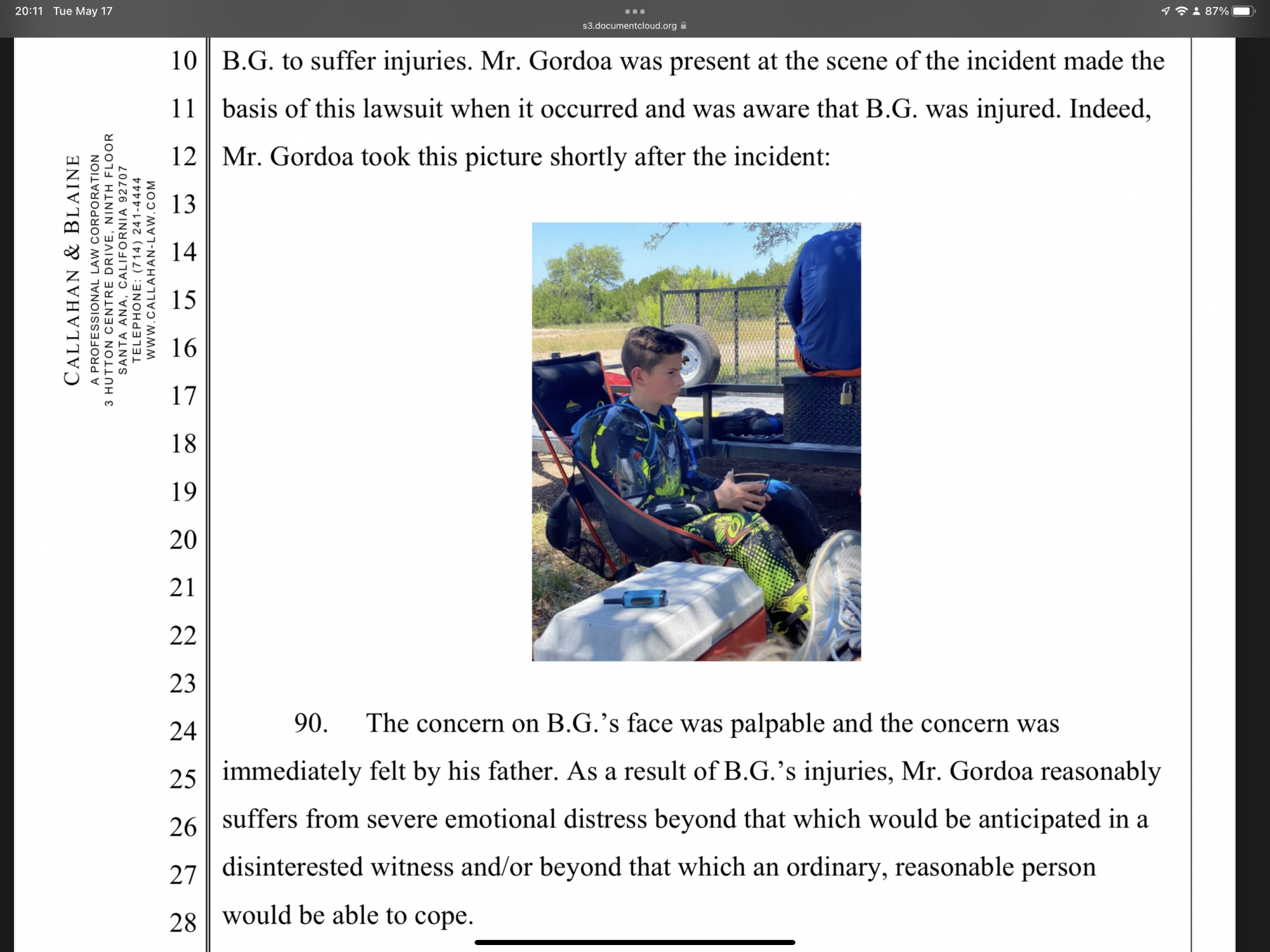

This is apparently part of the evidence of the incident. According the the lawsuit, this is a picture of B.G. after the incident.
The other thing that I’m not seeing in the lawsuit is where the parents took B.G. to a medical center for diagnosis directly afterwards. In fact there’s nothing to show they did much of anything that day.
In addition, what isB.G. wearing? This looks to my (totally uneducated eyes) that it’s some sort of bike getup - not sure this paints a picture of a boy enjoying a lazy Sunday afternoon watching Netflix.
Very intriguing pic..... From MotorBike.....
How loud is a dirt bike decibels?​
According to one study carried in the state of California, the sound produced by a dirt bike should not exceed 96 decibels. This value denotes a sound that is more or less the same as a quiet roar and it is the most comfortable sound that is recommended for every dirt bike. Modified exhausts and engines can raise that sound level to over 130db or louder. A dirt bike can in some cases be as louder if not louder than a Harley Davidson running drag pipes!
