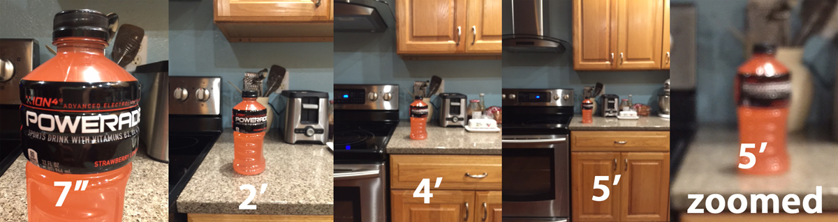

Found this thread when searching for answers about my iPhone 6+'s sudden onset inability to focus past the 6-8" range. I live four hours from the nearest Apple Store, so I sent my malfunctioning, totally immaculate iPhone 6+ in to get its camera replaced, only to be told that it was being sent back to me without any service because they had determined that it wasn't affected (even though it takes badly blurred pictures past the 6-8" range, AND is in the list of potentially affected serial numbers). That didn't work for me, especially when I have almost two years of AppleCare+ on that phone.

The real effect is MUCH more severe than that, basically blurry at any distance.
There may be some other issue, but it's not that one.
Focusing close is much harder than far (since depth of field is so small).
That's why again, this probably isn't the problem mentioned here.
Try to do the shot in broad daylight to see if there is a difference.
Since focusing is a lot easier in good light.
Again with this issue, there would be problem to focus even in very good light.
You could try to use a flash to see it makes a difference.
Use a tripod and do the same shot with one of your friends with a similar phone to see what the problem is.
Low light shots suffer from blurriness from high Iso? (also makes it harder to focus)
(causing a decreased resolution)
Are you using the stock camera app?
