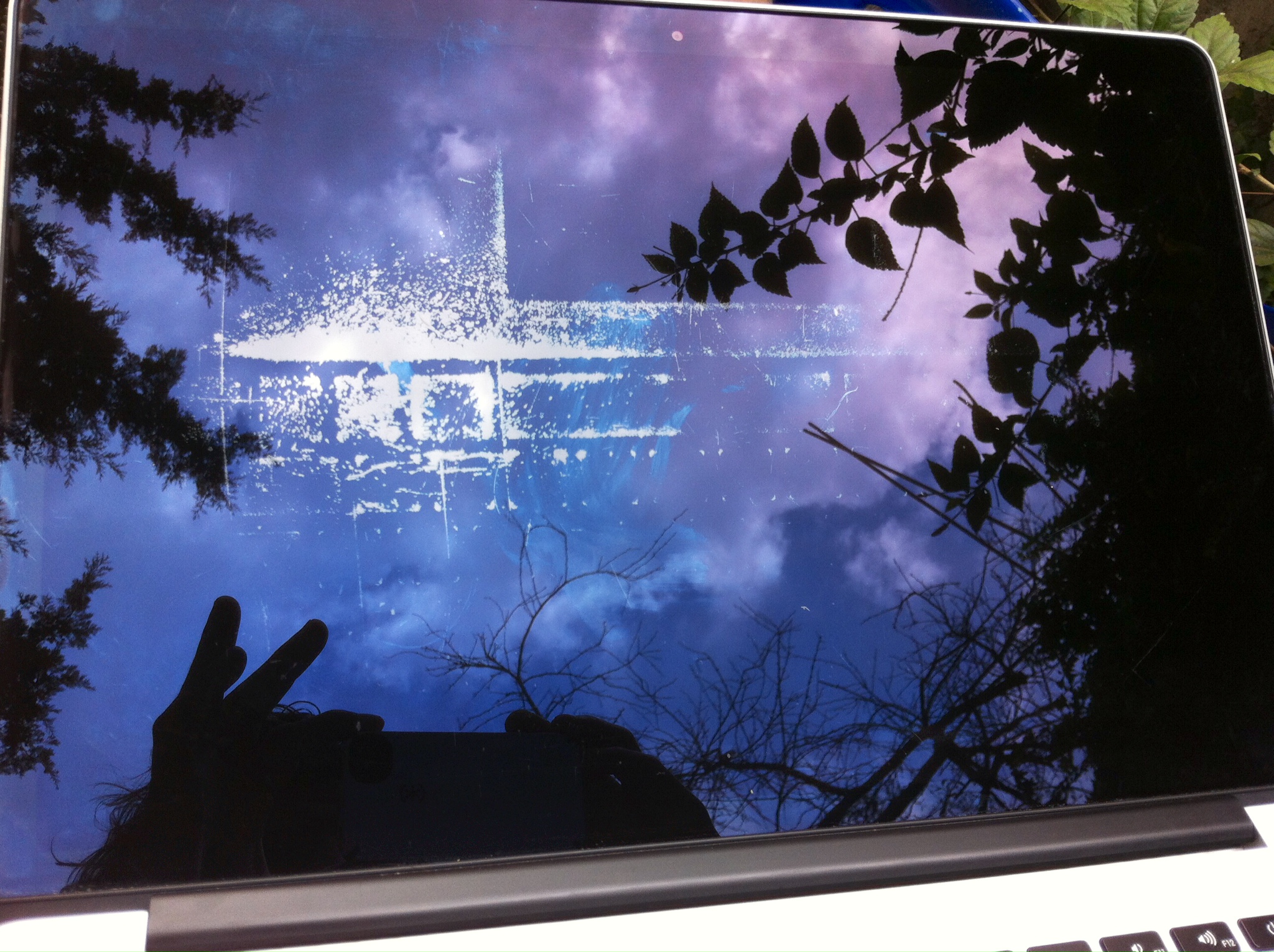

Should Apple just put their screen a little bit further to keyboard and aluminium surface? And use a thin support frame to isolate them, then everyone should be happy.
Reactions: Moki808
It might not be touching it actually but fact is, that the damage in the coating correlates to the aluminum casing. I can see the trackpad shape and the line where the keys end mirrored in the coating damage (similar two 2nd photo in the post) and that's a fact, not an assumption.
Plenty of the example photos show that it can't be the result of incorrect cleaning of the screen.
In this one you can even recognize the keys:
found at: https://discussions.apple.com/thread/6068947?start=75&tstart=0
Could this be from people using it in clamshell mode? Anyone see this, that has never used it in clamshell?

I had Apple care and took my rMBP in a month before its three years were up. One day I was cleaning some greasy keyboard marks off the screen with a microfibre cloth and a spot of saliva. I was rubbing with a "small" amount of force, not enough that the coating should come off.
Apple replaced the screen, noting that it was probably key pressure on the display - all they had to go on was a 5mm round blemish in the middle of the screen, all other keyboard grease marks came of fine before I took the rMBP to Apple.
I do carry my laptop in a backpack.
So what was it that caused the delamination?
  1. Long term use of iClear - I don't think so otherwise the whole screen would be affected.
  2. Use of a microfibre cloth with some pressure - could be, but must have some other factor too otherwise the coating is crap.
  3. Keys pressing against the screen while closed in a backpack. I could understand this, probably the most likely reason, but shouldn't happen. It took 3 years and a microfibre cloth to happen to me. Perhaps a mixture of 2 & 3
Apple covering this for 3 years only is slightly understandable, but personally to me should be more like 5 years.
Support documents from Apple clearly state to only clean the screen with a lint free cloth and water - nothing else - https://support.apple.com/en-au/HT204172. Mine started a a couple of spots - looked like dried water then it got worse. This is nothing to do with pressure as the screen has a black rubber seal / gasket around it and this touches the lower case, so this is not key pressure on the display as they don't touch and never do. That's more of Apple's excuses for lack of a better reason.
I would never use 3rd party products for screen cleaning as it's not recommended, supported or endorsed by Apple. This is a coating issue - apparently the way its been applied.

I own a 15" rMBP, a 13" rMPB and a 12" MB, along with an iMac and TV with anti-reflective coating. Only the 13" has ever displayed this peeling effect, despite all these objects getting cleaned in the same way.
The 13" rMBP displayed peeling the first time the screen was cleaned. This is unprecedented based on my long experience of cleaning anti-reflective LCD panels.

My rMBP when I put it in my backpack does have the keys touch the screen because I can see the skin oils on the keys transfer to the screen in the form of squares. I'd agree that I don't think this causes the coating to come off but couldn't rule it out.

I'm late to the thread but I don't think that is the cause of the problem here. I don't think proximity to the keyboard is the cause but rather the coating is defective in some fashion.
