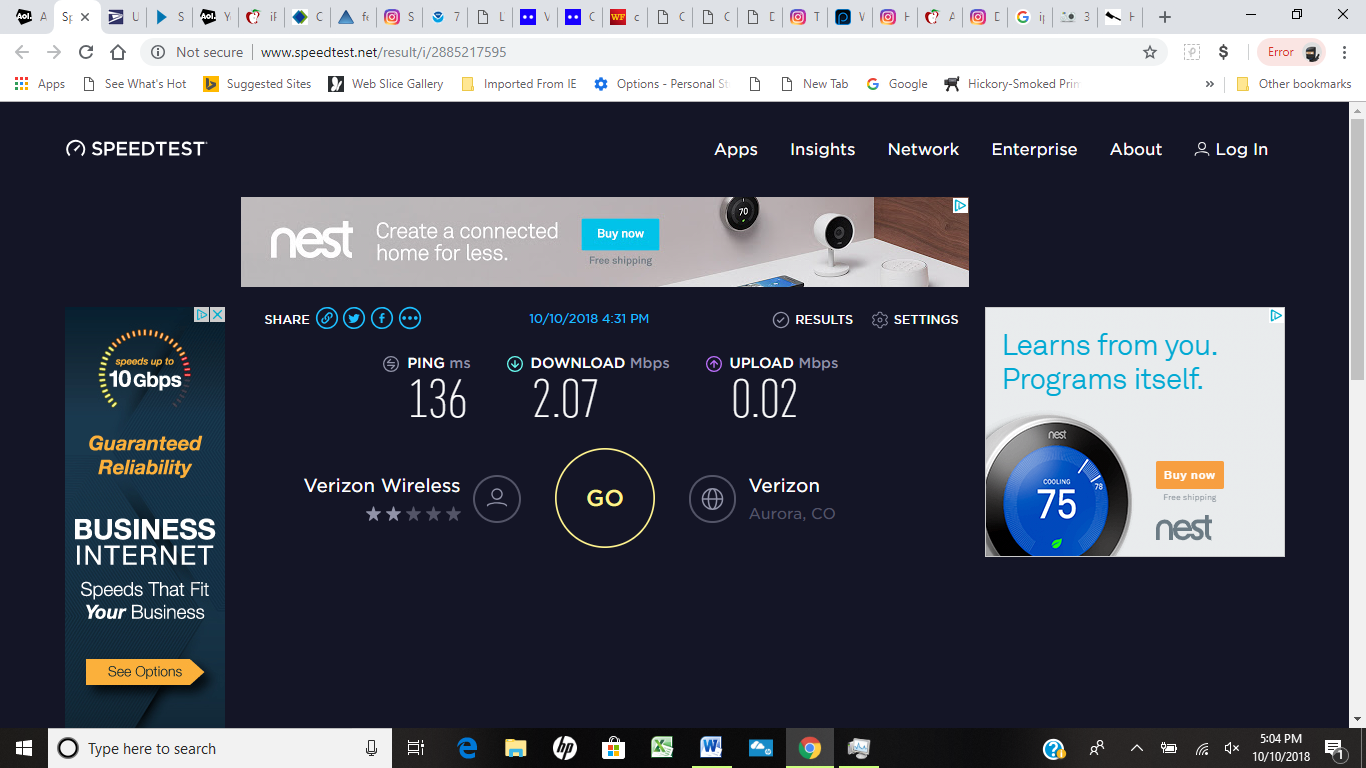

This is inside a store with 2 bars LTE

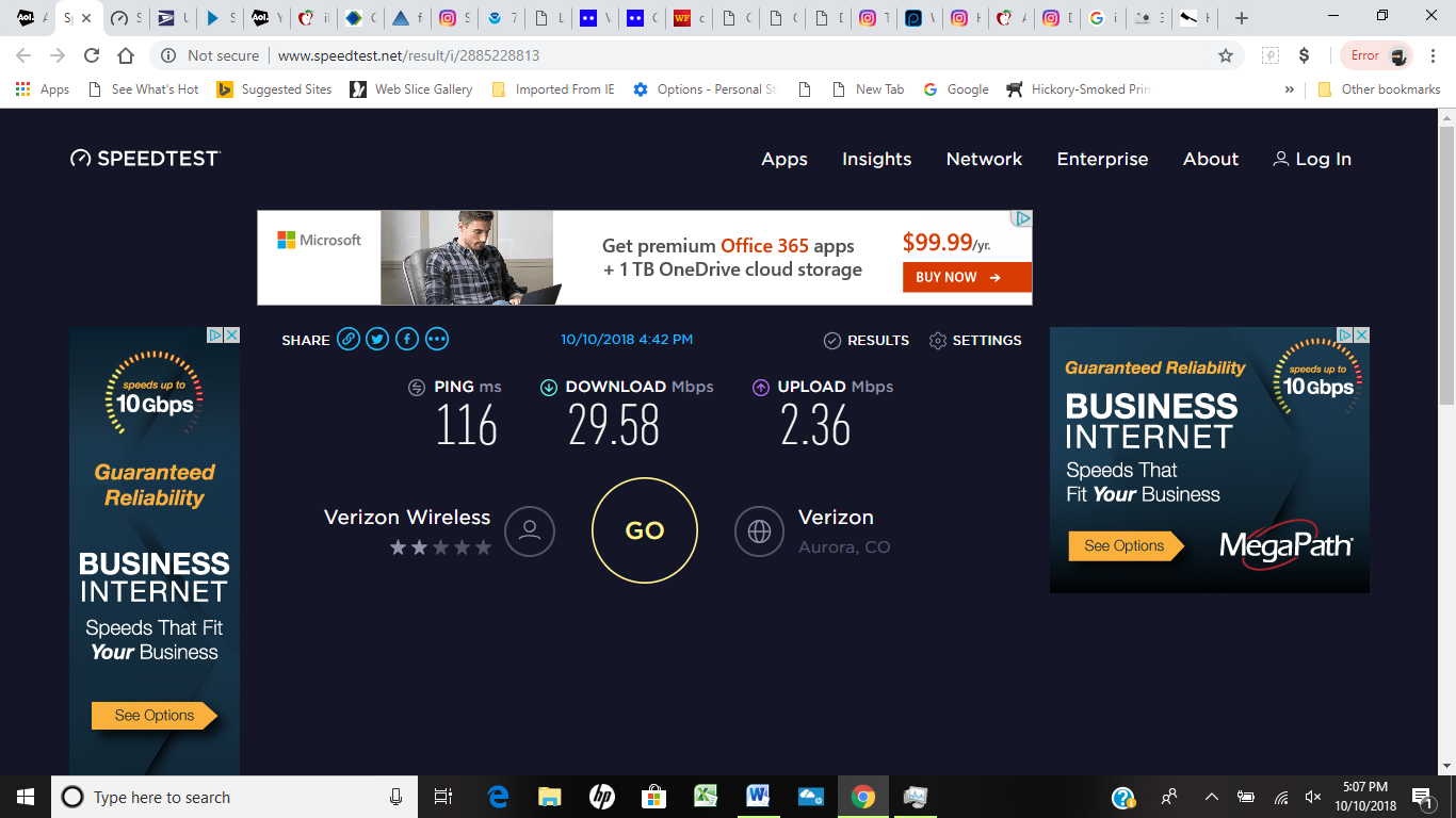

[doublepost=1539212979][/doublepost]This is outside the same store a few minutes later with 2 bars LTE. Iphone XS has very poor signal and throughput indoors. If this is like my previous iphone 7 I have no faith that Apple can fix this via software.
That’s clearly not true, because many tests show double the throughput of 2x2 phones. The issue is negotiation of tower connections, not the use of antenna.
View attachment 793884View attachment 793884
Most of these retail stores that sell mobile products for cellular activity will have equipment installed to boost frequencies used by carriers. These data readings are irrelevant because they would probably be considered an outlier. Just an FYI.
This was not at a Verizon Wireless store. Just an example of how the signal degrades indoors. For my XS this happens all around town, outside town, at home etc. Both XSs had the same poor reception so this makes the probability that a hardware swap will help less likely.
I did do a test at a Verizon Wireless store and I had 8.14 down and .095 up with rsrp0 -105; after toggling airplane mode it went 33.6 dn 15.8 up and -75 rsrp0. XS did not switch to better signal in store on its own.
