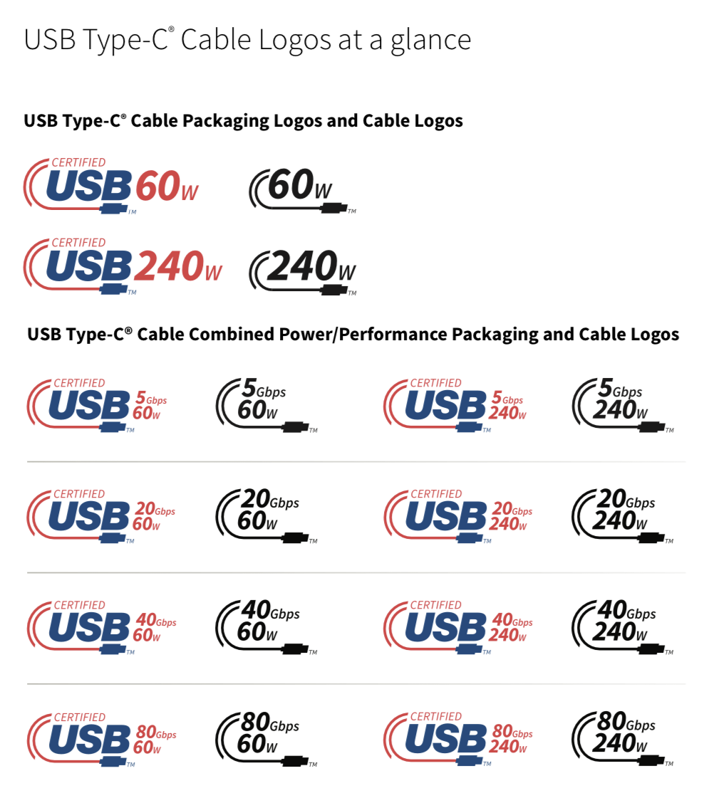

Yep. USB-C is just the physical connector, not the USB protocols. There are new logos that are intended to help with that:
(https://www.usb.org/sites/default/f...able_logo_usage_guidelines_final_20230818.pdf)

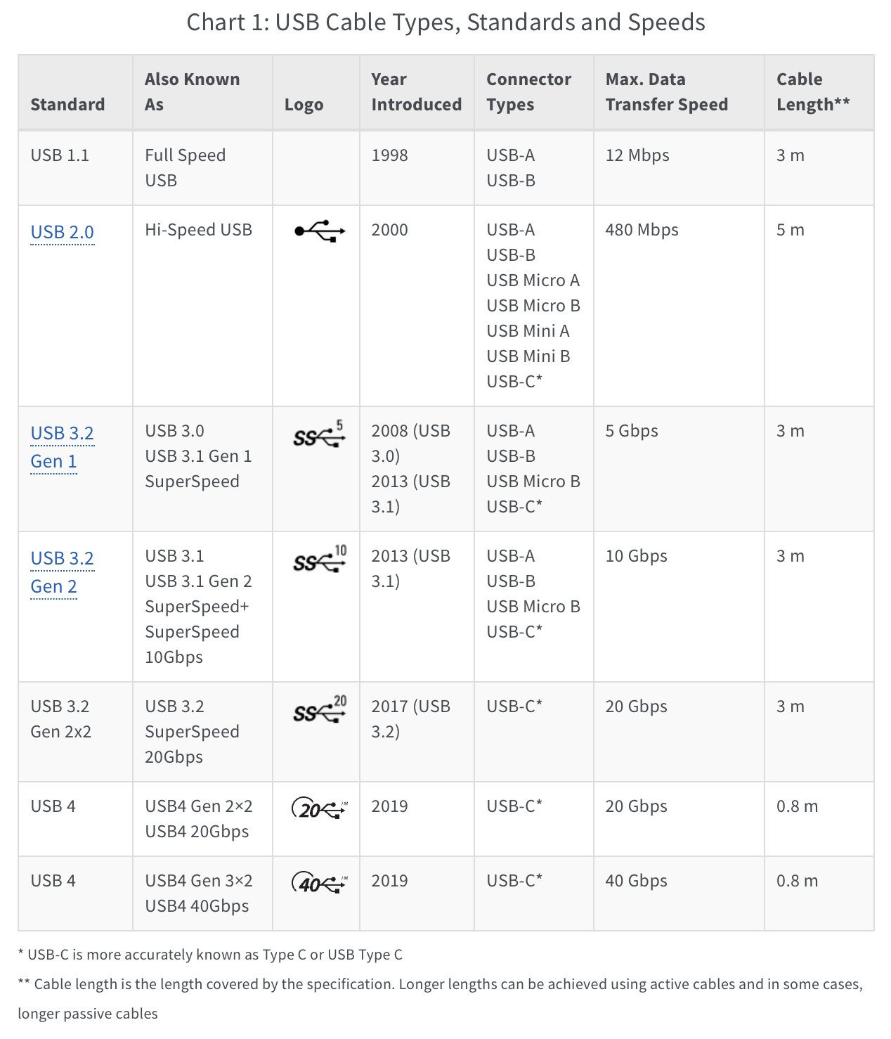

However, restricting USB-C to USB 2.0 speeds unless you buy a $130 cable, is the very definition of dumb (and greed.)
USB C cables come in many capacities. It's not a restriction that you need a more capable cable in order to use higher speeds and charging rates.
Thunderbolt ≠ USB. They’re two separate protocols and have different requirements in the cable to function, but just the same connector, USB-C.

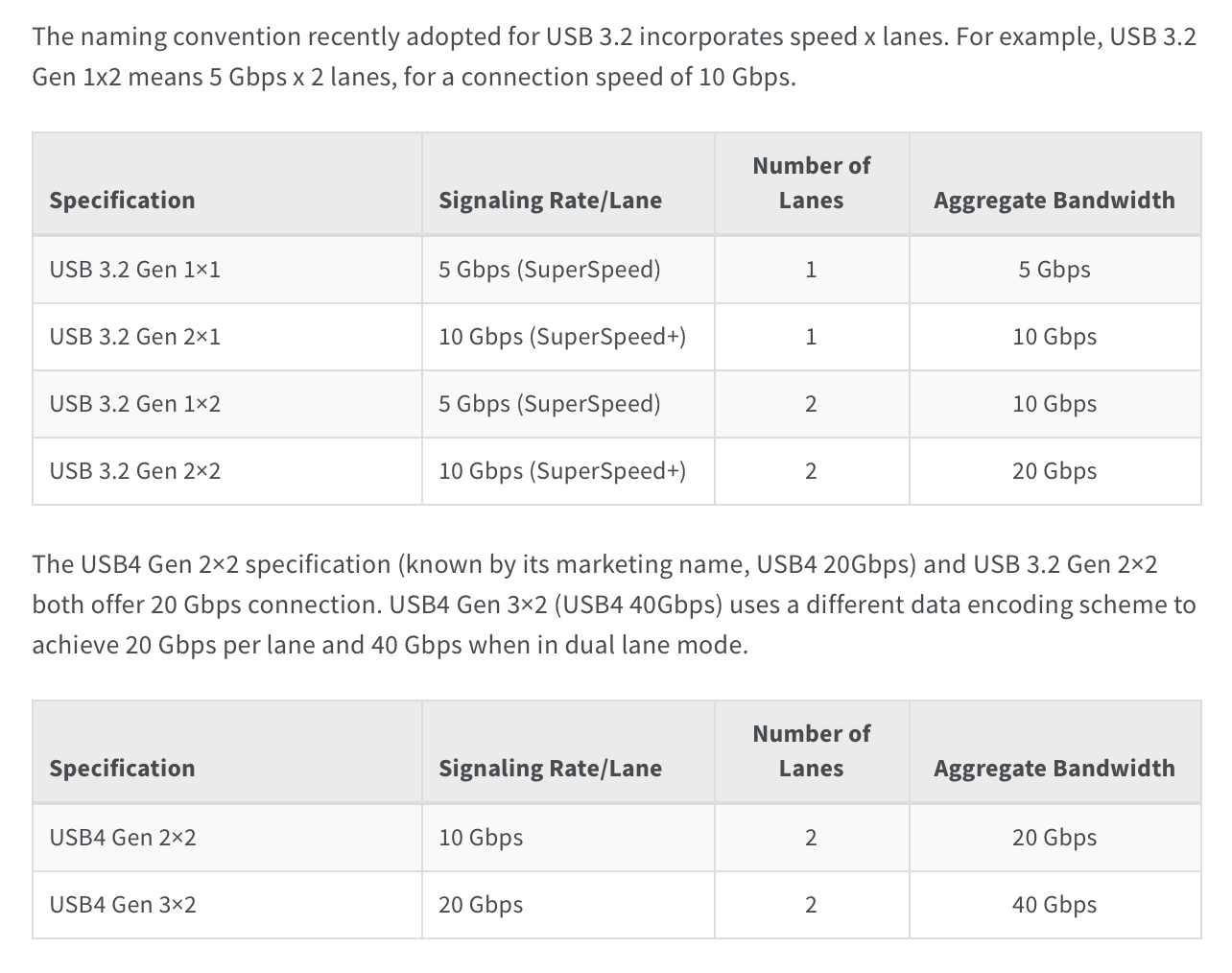

What is "full speed"? USB 3.1, 3.2, 4? Why include expensive overkill cables that most people won't use?

The EU legislation only covers charging, and not data rate, so I don't think so.

The vast majority of USB-C cables are not thunderbolt capable. You typically have to buy separate USB4/Thunderbolt-capable cables to support this. This is because Thunderbolt 3/4 requires optical cables in order to support the full speeds for cables longer than about half a meter or so. These are fairly expensive to produce and are rarely packaged with products out of the box.

An usbc cable is not a dumb cable. Inside the plug on both ends you will find a small circuit board. The interface chips on this board determine what speeds the cable will support (that and the quality if the cable itself). The reason lopnger quality thunderbolt cables cost so much is that the cables will have individual shielding of each sub cable and this bundle will again be shielded. This youtube video shows wht the longer usb4/thunderbolt cables are not cheap:
