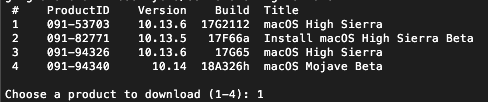

If it isn't working for you via the mac app store as expected and you want to force a download of the full installer of 10.13.6 bypassing the mac app store altogether you can use the python script installinstallmacos.py as follows within Terminal instead.
First download and install python from https://www.python.org/downloads/ if you don't have python already.
Then make a folder python in your /Documents folder
Now you may save the following script in your python folder called installinstallmacos.py:
https://github.com/munki/macadmin-scripts/blob/master/installinstallmacos.py
And to run it you can use
sudo python /Users/YOUR USERNAME/Documents/python/installinstallmacos.py
Type your password and then it downloads some stuff and gives you some options:
Downloading https://swscan.apple.com/content/ca...n-lion-snowleopard-leopard.merged-1.sucatalog...
Downloading http://swcdn.apple.com/content/down...rhtc77wsyme21xhi8f0x/InstallAssistantAuto.smd...
Downloading https://swdist.apple.com/content/do...2crhtc77wsyme21xhi8f0x/091-82771.English.dist...
Downloading http://swcdn.apple.com/content/down...zbgeqlaurw2t9zxl8ku7/InstallAssistantAuto.smd...
Downloading https://swdist.apple.com/content/do...t7zbgeqlaurw2t9zxl8ku7/091-94326.English.dist...
Downloading http://swcdn.apple.com/content/down...dr8nbldf7rve8sk7ycio/InstallAssistantAuto.smd...
Downloading https://swdist.apple.com/content/do...gzdr8nbldf7rve8sk7ycio/091-94340.English.dist...
# ProductID Version Build Title
1 091-82771 10.13.5 17F66a Install macOS High Sierra Beta
2 091-94326 10.13.6 17G65 macOS High Sierra
3 091-94340 10.14 18A326h macOS Mojave Beta
Choose a product to download (1-3):
So the one you want is 2 so type 2 and press return and something like the following will happen and will download each component of the installer and then create the full installer inside a sparseimage:

There is a new full installer of 10.13.6 available for the 2018 mbps build 17G2112 as reported by installinstallmacos.py.
So this could be used to restore the system on the new macbook pros.
Downloading now. Will make bootable usb later.
Just note that the boot process is different for this mbp due to the T2 chip which is more restrictive on letting things like a bootable usb to work. They will still work but there is something else you need to do in order for it to work on these new machines.
If you want to boot from a bootable usb you have to enable external booting. To do this startup with command R first. Then in the menu bar choose Utilities > Startup Security Utility, enter password and click allow booting from external media.
Also unless there is going to be betas for 10.13.7 then we need to update installinstallmacos.py itself.
So I opened it up with BBedit and replaced the code 10.13seed with 10.14seed-10.14 i.e., change this code:
DEFAULT_SUCATALOG = (
'https://swscan.apple.com/content/catalogs/others/'
'index-10.13seed-10.13-10.12-10.11-10.10-10.9'
'-mountainlion-lion-snowleopard-leopard.merged-1.sucatalog')
to
'index-10.14seed-10.14-10.13-10.12-10.11-10.10-10.9'
and then saved it as a second copy of installinstallmacos.py which I called installinstallmacos2.py
and if I want to run it I do it like this instead:
sudo python /Users/YOUR USERNAME/Documents/python/installinstallmacos2.py
and the options are less because it doesn't have the 10.13.5 beta build 14F66a
However I don't mind. It needs to be updated like this to be sure to get the builds available from the mojave beta seeds instead of the high sierra beta seeds as they are likely to end soon assuming there won't be a 10.13.7.
