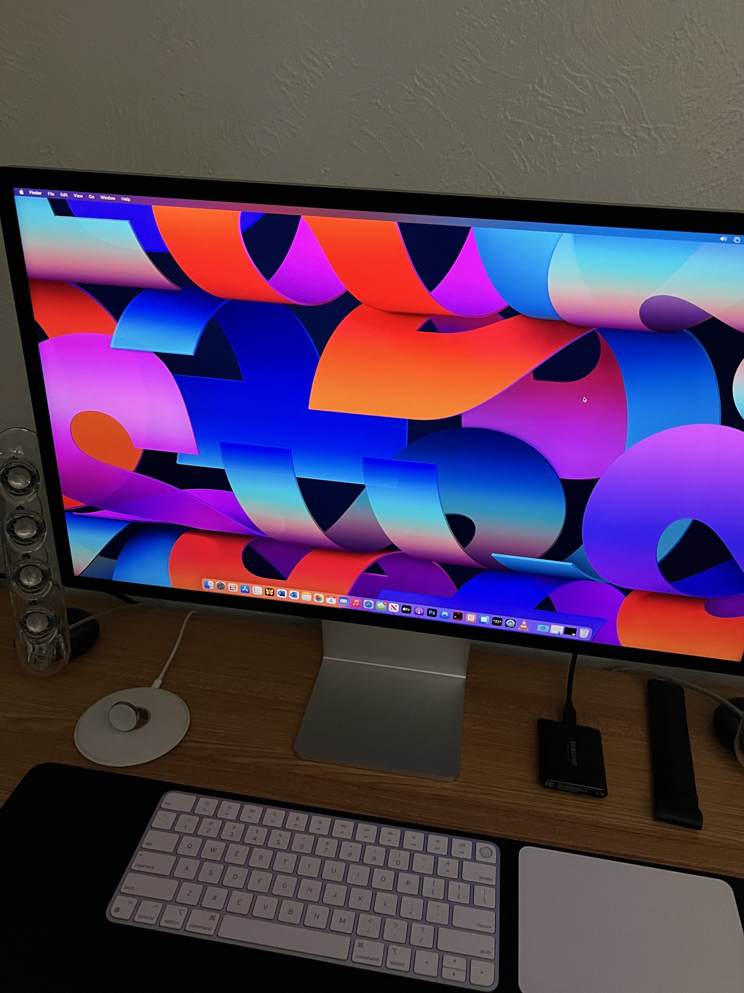

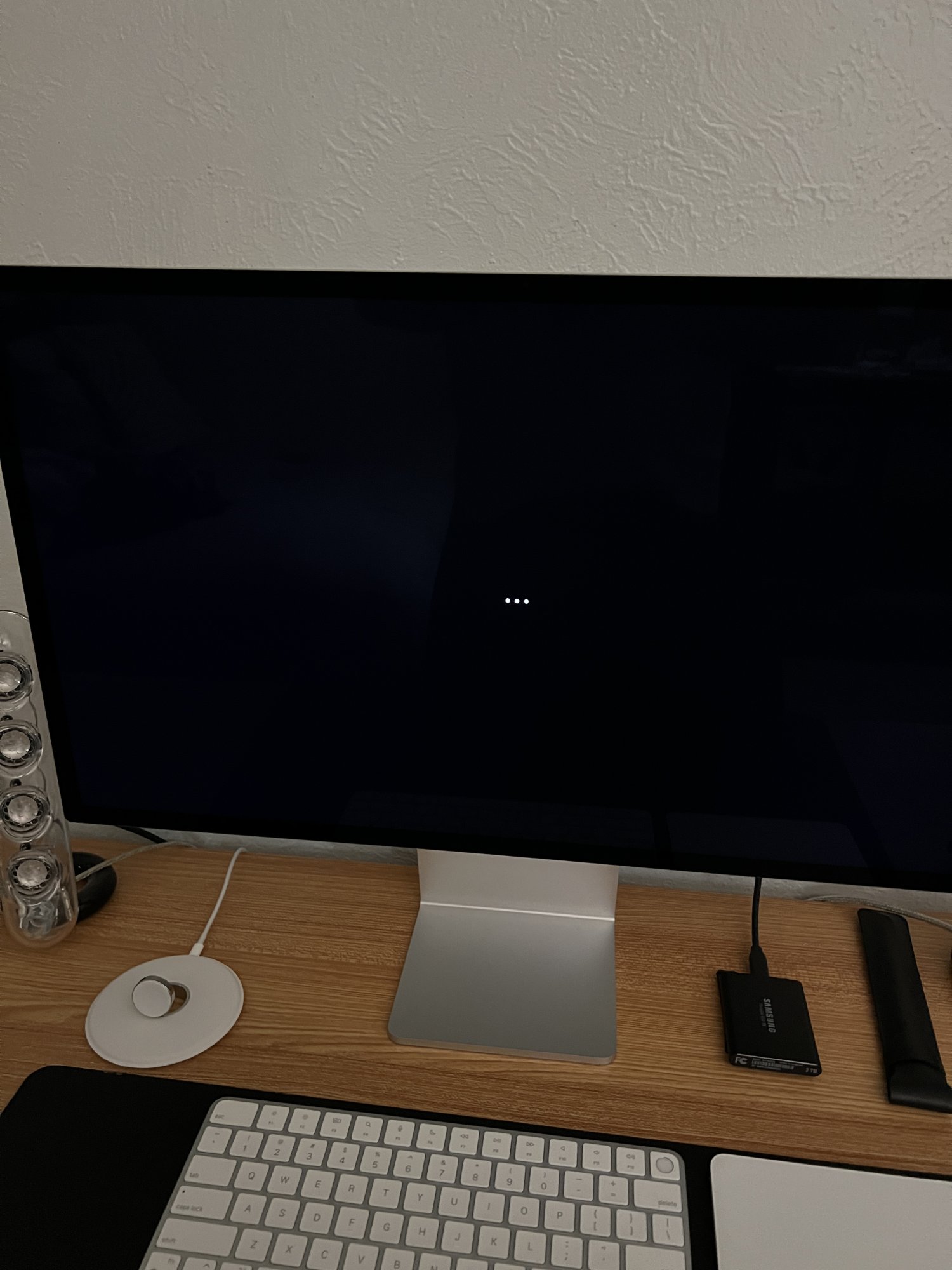

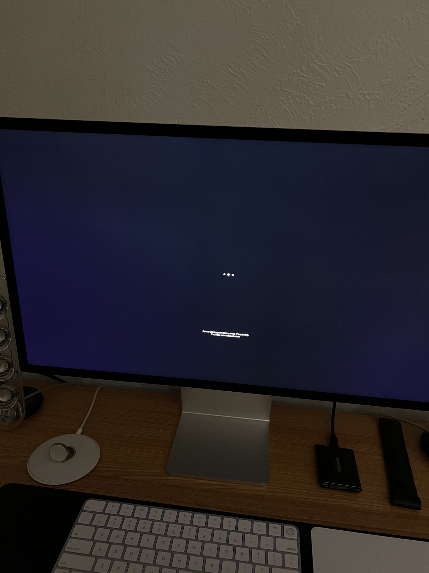

I've just run the update and it went through in about 5 minutes without a hitch, updating both ASDs from my Mac Studio M1 Max in parallel.
The updating status was displayed on the non-ASD 4k display some of the time while the ASDs went through their "• • •" low-level updates.
I can't say what my difference is to the user who had some issues with the update (other than having another monitor connected at the same time), but it just went through.
After the Mac rebooted the ASDs do indeed show up with the new firmware revision and sound works as it should, although I'm normally using separate speakers via the headphone jack on the Mac Studio.
