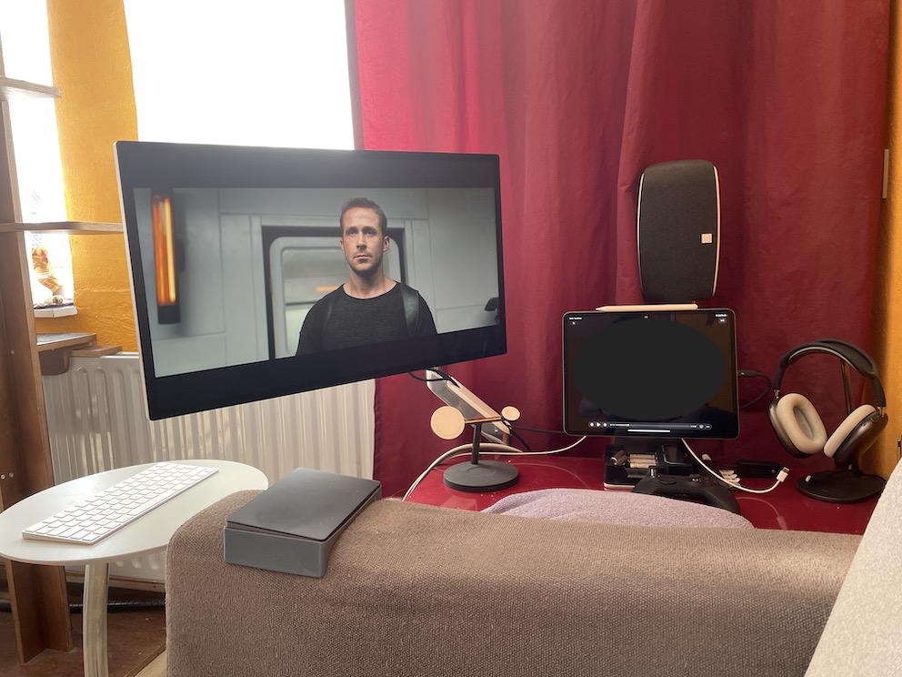

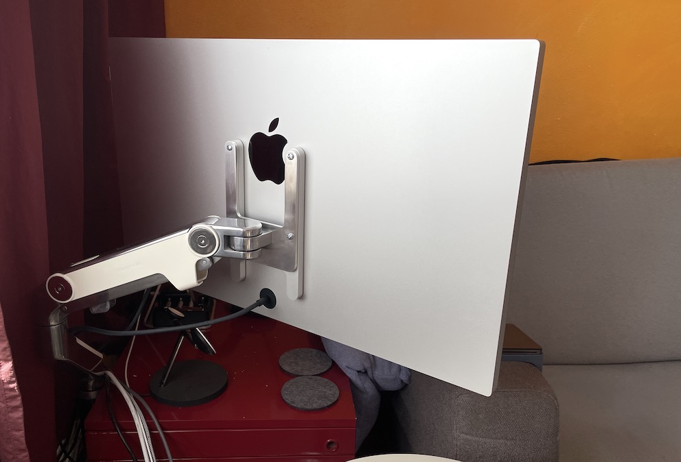

What stand is that?
It's the Humanscale M8, it is a bit oversized for the Studio Display, but my iMac 27" was on it before.
I might go look for the thinner M2 version, or another brand, as the Display is much lighter.

Please do explain your setup, as I fail to see a "workstation" here. Not sure if it is the angle of the photo, but I can't imagine where you sit and where the keyboard/mouse are and where is the center of this setup.
My first pic probably makes it more clear, the Studio Display sits just beside my couch, trackpad on the armrest, and keyboard on the little table.
I do a lot of 3D modelling for 3D scanning and 3D printing, and don't need a desk,and can pull the screen more in front of me when needed.
this is a very comfortable way to do work 🙂

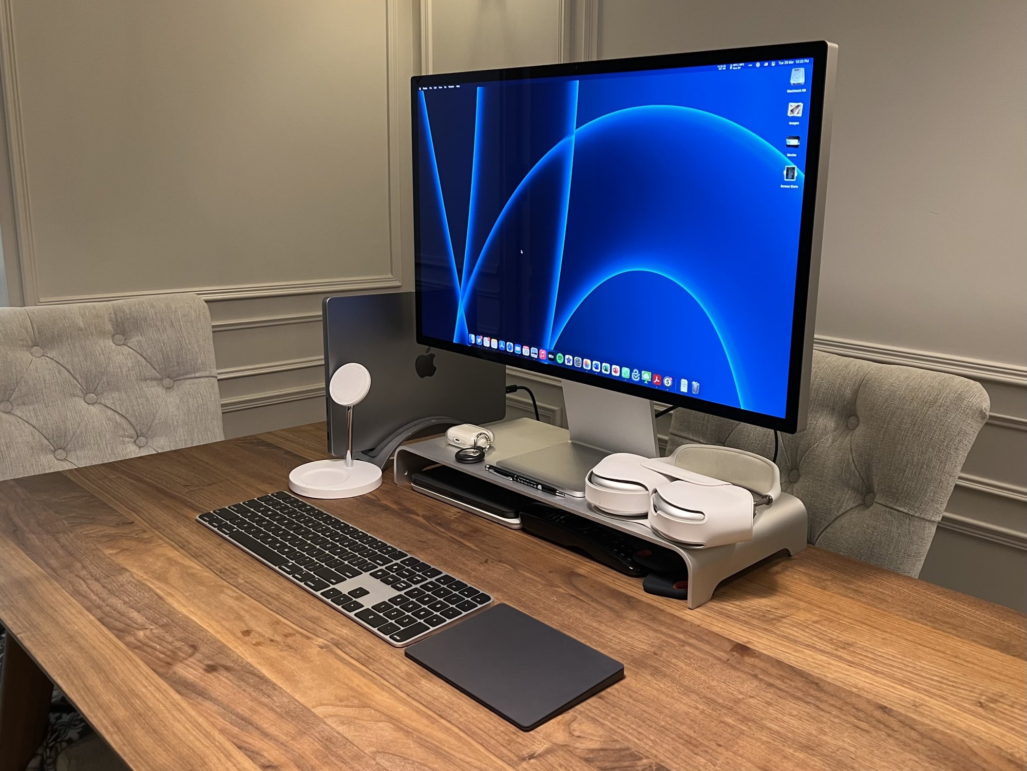

BTW, congratulations ITsamsamsam on having a desk with actually some room for writing and displaying reference materials. Very refreshing after looking at mostly cramped desk layouts recently.
thank you!! sometimes my friends make fun of me because my desk is too tidy but i can't work differently ... i like to feel my space "breathe" 🙂
