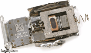

Can someone elaborate more specifically, but more importantly in basic terms, how the linear actuator works? I love the way it feels on my wrist and I've always been one to be curious on how things work
First, think about how phones used to vibrate. They used a tiny electric motor rotating an eccentric mass, just like a clothes washing machine spinning an off-balance load. The frequency (rate of rotation) could change, but it was difficult to control the amplitude.
A linear actuator is also a magnetic motor, but instead of rotating an eccentric mass, it oscillates a mass back and forth. Here, I've made an animated GIF of the torn-apart insides of the actual Apple Taptic Engine for you. (Note that the spring on the right would be held tight against a right hand wall that's missing here.)
Of course, it normally vibrates back and forth much faster than that 🙂. Because it's a mass attached to a spring on each side, it has a natural resonant frequency where it works the best, which is usually about 175 Hz for haptic actuators.
But while the frequency can't be changed, the amplitude (how far it swings back and forth... like the volume of an audio waveform) can, which is considered an advantage for creating various haptic feedback sensations.
(This is partly why Samsung switched over to linear actuators back in 2012 starting with the Galaxy S3. Apple finally switched from eccentric mass to linear actuators with the iPhone 6.)
Btw, Apple had a patent on a "tapping" version a while back, which probably applies here as well. The idea was that with a high amplitude applied in one direction, the mass was purposely allowed to hit one side, not just run back and forth suspended in the middle.

Here, I've made an animated GIF of the torn-apart insides of the actual Apple Taptic Engine for you:
Thanks for the graphic. When I look at the guts of the Taptic Engine, I don't see a precision mechanical device designed to last for a decade or more. In fact it looks similar to the underside of a 1960s HO slot car. While the exterior of Apple's watch is finished to the nth degree, the internals are oddly crude.

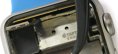

That's because whoever generated that picture bent and tore their way into the metal casing. It looks pretty good to me if you just look at the undamaged parts.
Apple marketing led people to visualize unicorn-like smooth perfection:
While in real life, the Taptic Engine looks, as you said, more like a simple, inexpensive, thin metal, linear motor, with ventilation holes. Which is, after all, exactly what it is.
To me, the Sport's bracket for the Digital Crown is also a bit cruder looking than expected.
But as you said, the outside is nicely done, and that's what matters to most people. I think Apple has moved on from the "make the backside of the drawer look just as nice" era of Steve Jobs.

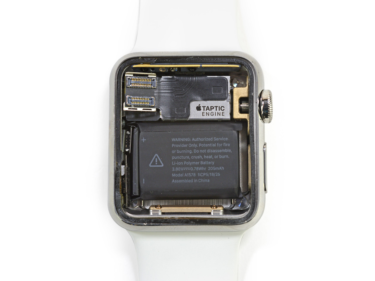

I remember reading reports that the crown attaching bracket inside a stainless steel Apple Watch is beefier (nicer) that the bracket inside the sport model. Perhaps the stainless steel's taptic engine is prettier on the outside too? 🙂
Edit: Yep, the crown bracket is much more substantial in the stainless steel model:
But, the taptic engine looks the same. Not anything like Apple's initial photos of the taptic engine.
