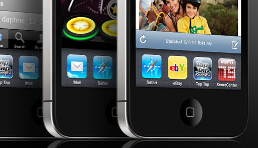

What I don't understand is, why not put the break on the top of the phone instead of the bottom? Who holds their phone from the top? Even on the right side would be better as most people are right handed and hold the phone in their left hand so they can tap with their right hand fingers.
But anyway yeah, this is starting to look really bad for Apple. It definitely seems to be a design flaw that is widespread in who it effects and that amazingly no one caught before it was released.
Have you even looked at an iPhone, it already has seems on the top and the right separating the antennas.

Would it really matter if the attena was on the top or the bottom ? People are still going to complain, and when someone does find an issue all hell is going to break loose.
People would still complain yes but not to this degree. Apple has a big design flaw that has sat in all the iPhone and they still have not fix it. If anything they made it worse because people are shorting out the antenna now. At least before all you did was block it. instead you short it out and prevent it from working.
Top half would of been a MUCH MUCH better location for it.

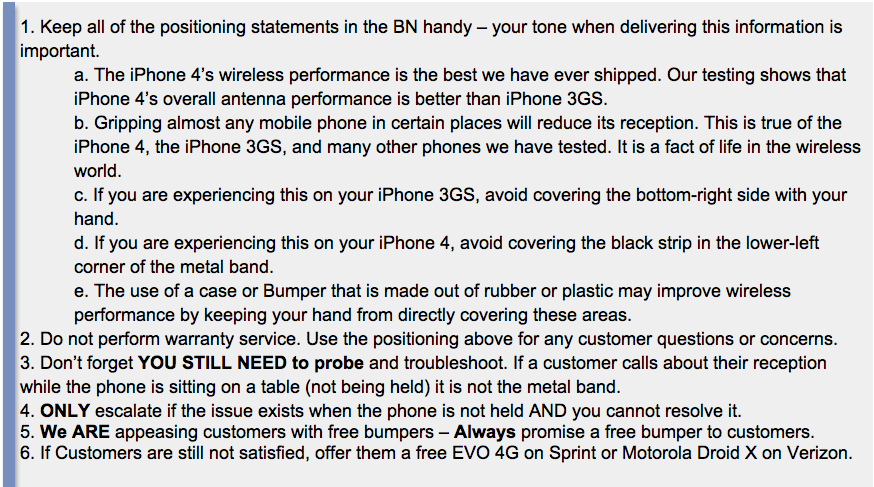

Actual Procedures
I have what I believe are the actual procedures! Please note: Mine are an actual screenshot and not just text typed into a web page like BGR! I do not have an "Apple Connect" who can provide me with compelling evidence like a gray DIV, but I can hit SHIFT-COMMAND-4!

Apple was stupid in putting the antennas on the bottom half of the phone. there is a reason that most phones put the antennas in the top half and on top of that do not allow the human hands to SHORT OUT the antenna. Apple has not figure out the top half trick in 3 years. Most people hold a phone the the bottom half if the half touch.
Apple clearly screwed over its engineers in this one. They choose to look pretty over design something that works correctly.
The FCC requires manufacturers to put the antenna at the bottom now, since putting it at the top puts it too close to your head. Don't blame Apple for complying with (stupid) regulations.
