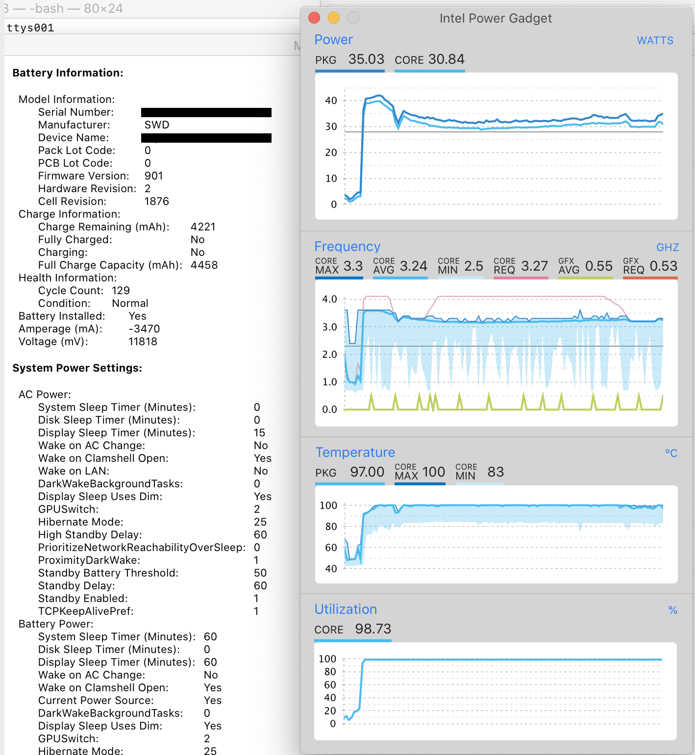

For comparison, my 2020 quad core intel i7 13 inch uses <10 Watts doing simple stuff, and maxes out ~40W under full load:
3.47A * 11.8V = 41 Watts. And this is an extreme, sustained workload. Few users will be doing this kind of high CPU task for long periods of time.
