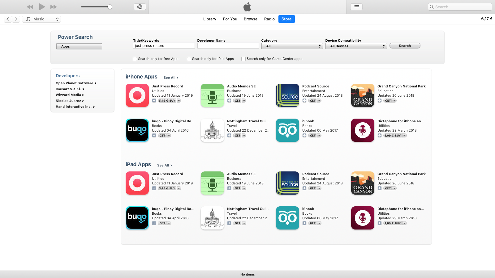

I thought the latest version of iTunes didnt have the App Store, but I just stumbled on this
I'll bet that if you tried to use that "store" page, it would only partially function, if it all.
With the stores, iTunes is really only displaying specialized web pages that are rendered by the WebKit framework in the OS. 12.7+ probably doesn't know how to handle those links even if it's able to display them.

I can't figure out the steps to even find that page
Just type https://AppStore.com/<name of a known developer> then when the iTunes page appears, click PowerSearch (top left).

Its great to read all about the iOS apps on a large Mac screen. Also it appears you can buy iOS apps from there. Haven't done much testing yet. Just thought I would let people know as it might be of help.
It automagically opens the developer in iTunes 12.9.2.5 from Mojave, and no PowerSearch.
