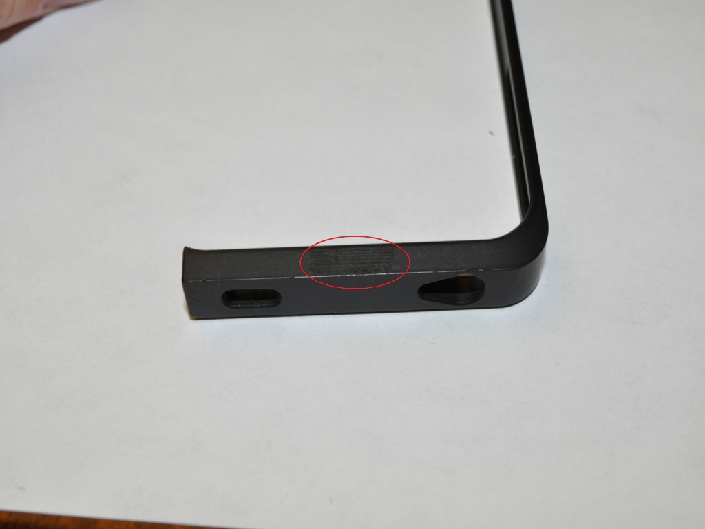

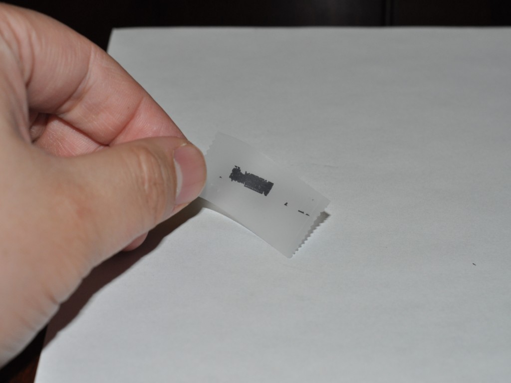

you can see from the pictures below the coating that came off on the scotch tape and the corresponding area on the frame. the coating gives it a matte finish while the underlying piece has a plastic finish.
in any case, i'm happy with the way atomic took care of me. maybe the frame that i got didn't get "baked" enough.

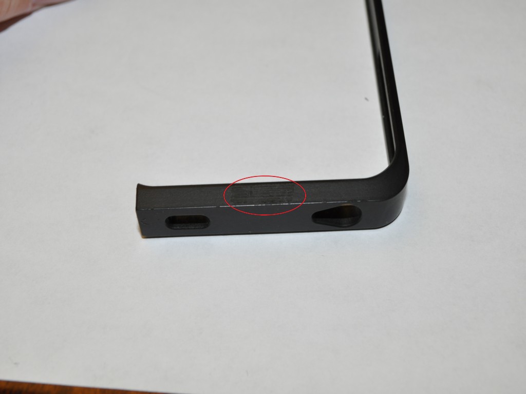

It's a little disturbing to me that applying and removing scotch tape can remove the finish. Seems like a fragile finish. Maybe this was just a fluke.😱
But I was told that there were 7000 of these cases out there and not 1 return except the one on here so I would say it was a fluke! Cause like I said, mine fell around 4 feet and it didn't flake or anything.
Baked on coating on the delrin? I would love to know more about this. I'm not sure why the delrin needs a coating? They make black and white delrin.
Delrin can be coated with various materials, either to further enhance it's chemical resistance, or purely for cosmetic reasons. The surface would be chemically etched (or should be, ideally...even the manufacturer Dow recommends this) to aid in bonding of the surface coating.
And correct me if I am wrong here, but I don't think delrin comes in black. They have to make it that way. I was told that it only came in brown and the rest of it was made different colors using various methods.
Delrin AF is the only delrin that I know of that comes in brown (from the material it's made of), but it's not used in these cases. It's far, far too expensive for that. Delrin's natural color is white (that's why many distributors list white as "natural"), and it is made black (through dye, I believe). I think it's this addition of the dye to color it black that makes black slightly more brittle and less impact resistant than white. White is typically known as the most pliable, most impact resistant of the two delrin colors, although no delrin has the impact resistance of standard "cheap" polycarbonate (the plastic used for most iPhone cases). Refer to the chart I posted in the Fusionwerkz Raw thread showing polycarbonate as being right at 6 times more impact resistant than delrin. I honestly expect to see many of these delrin cases breaking (as yours did) as they encounter drops, especially in the thinner areas of the case (like near the dock connector). I'm not knocking Atomic for using delrin, as it's fairly strong and pretty cheap, but I think the design should have been altered to strengthen the thin parts of the case. Looks like their soon to be released "Silverback" delrin/aluminum hybrid rugged case will address that.
