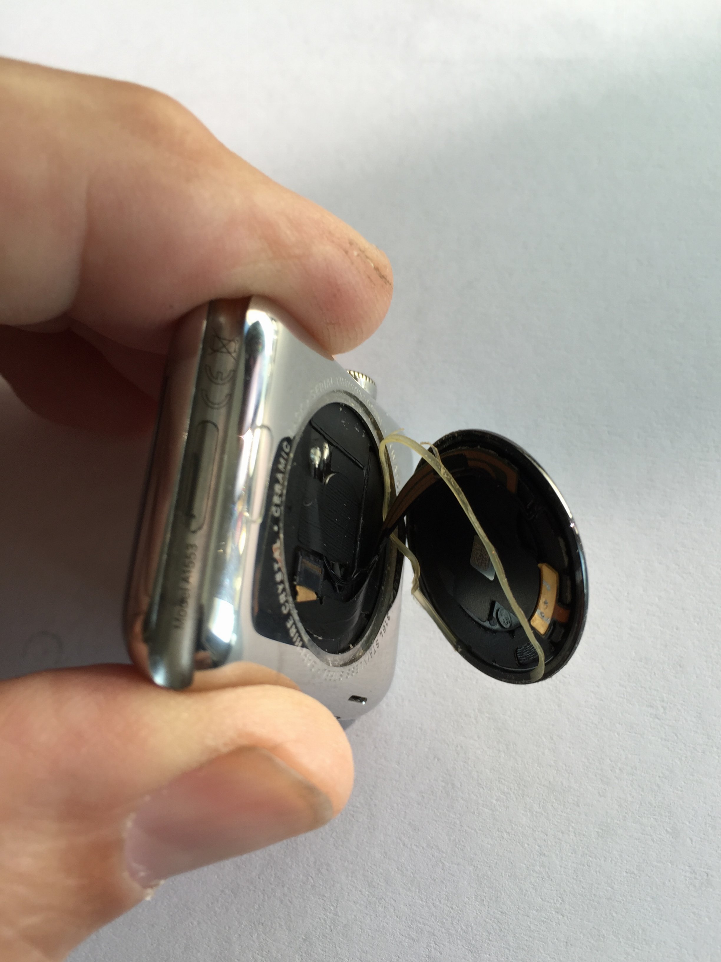

Bad morning! The back just fell off on my 38mm SS watch as I pulled it off the charger. I have had the watch for close to 13 months. Fortunately I got AppleCare+ on it. Waiting for the Apple Support phone line to be available.
Update:
Apple Support is shipping a replacement. Should be here today or tomorrow. Here is a picture of the back occur watch. You can see a ring that is either a seal or a head of glue.
