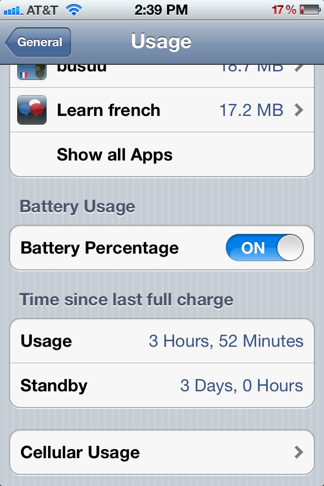

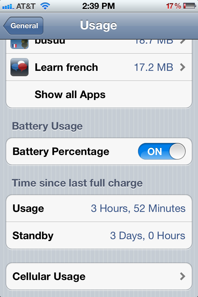

iCloud OFF, WiFi Sync OFF, Location Services ON (except Time Zone Setting), iMessage ON, e-mail checked every hour, Find My iPhone ON, Appstore Login ON.
