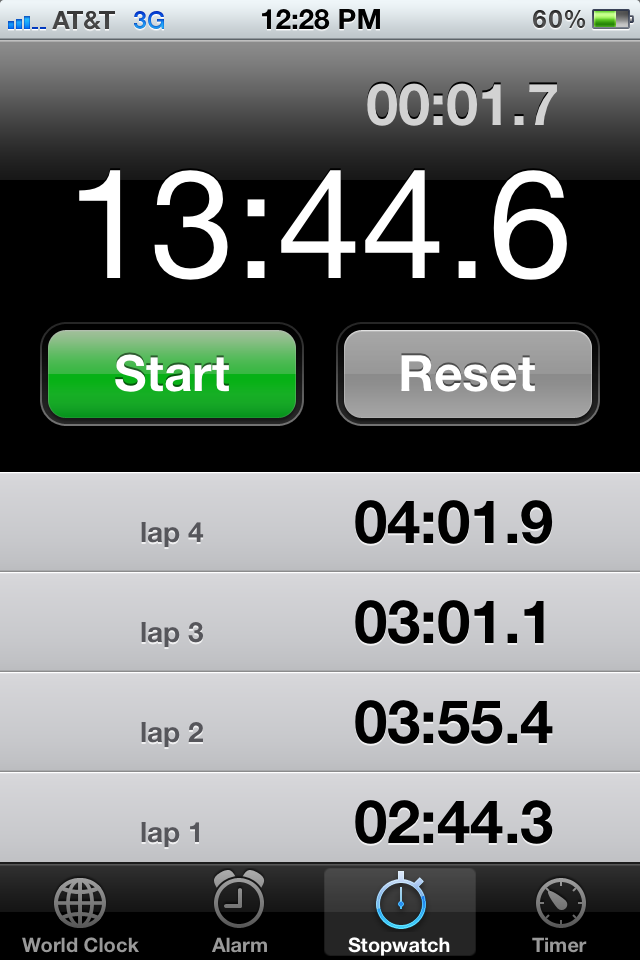

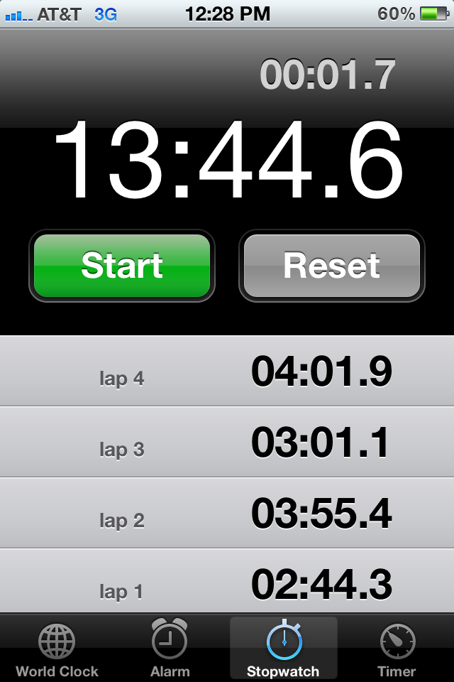

I used the stopwatch function to time exactly how much time would pass to lose 1%. The laps are the time between every % of battery power. No other apps are open.

My 4S is getting absolutely terrible battery life. Today after charging to 100%, I'm now at 94%. It's been just under an hour (50 odd minutes) and literally the only thing i've done is text my girlfriend. **** sakes.
This is very stressing...
It's not a perfect science, the battery is not going to drop a percent at the same rate each time. A lot of this is due to the system used to measure the capacity of the battery itself.
The numbers are fairly theoretical and not be taken for anything beyond that of a reminder of when you should plug in your phone.
Chill out and play some angry birds. 😀
No it's not a perfect science but it does show a serious issue with battery draining. I can't play angry birds if my phone is dead!

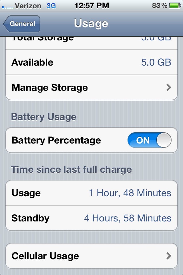

Anyway. Will see how the battery is now after a full charge. It's been dropping 10% in under an hour since I got it.
Is this good or bad? Lol

notifications
Over on businessinsider they commented that the notifications center apps like stocks and weather are constantly updating, not only when the notifications center is opened and therefore are using up battery.
I'm going to move them OUT of the notifications center and see if things get even better.
