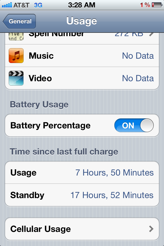

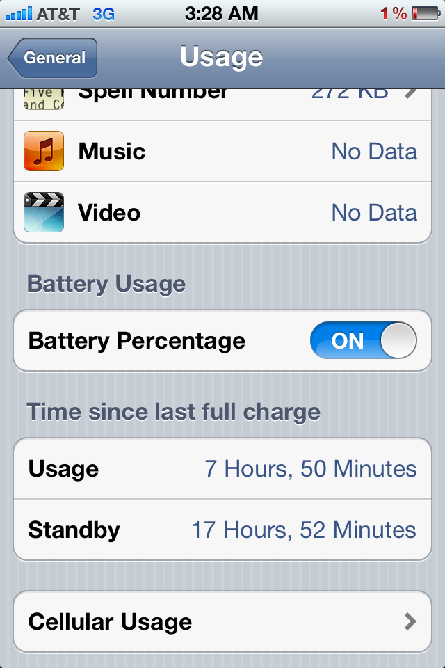

I have not done a restore yet, i do have some settings off that were recommended to turn off, and i have screen brightness about 25% i just like it that way , sometimes at 20% am just used to having my devices dimmed down mac , ipad or iphone. this was yesterdays usage ,mostly web browsing on wifi , and texting , normal talk, no games yet, no streaming of music or movies . i have two gmail accounts set up as exchange for push, last night i let it go till it turned off to do first calibrate. Going to check it out today see how it goes, even though i didnt feel i had problems towards the end i had to force the phone to die played some youtube vidoes and ect, in all am satisfied with my battery for now, hopefully it doesnt get to bad once i really start using it.
by the way , i love my screen , no yellow tint, no huge bluish tint , just perfect
and my phone has not heated up on me, ill try netflix or some games and test it out more
