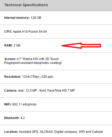

Anyway, also check this screenshot, I do have 4,7 inch model (classic iPhone 7) and SNDeepInfo says that I do have 3GB RAM (of course, not sure how SNDeepInfo can be trusted). I mean IP7 is supposed to have only 2GB RAM, or?

Also, SNDeepInfo tells me my phone was build week 39 (26.9-02.10). Considering my phone is arriving today, I find it hard to imagine it was built within the past two days.
