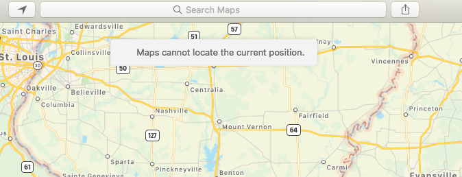

For years, my Mac Pro has intermittently given me the "cannot locate the current position" error when I open the Maps app. Sometimes it works fine for weeks and then other times, it just stops working for days or longer. Sometimes, it fails immediately and then works a few minutes later.
It was working up until a week ago, but I had to reinstall High Sierra and now I am back to "cannot locate position". What are the root causes of this issue and are there any good solutions or workarounds?

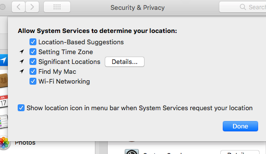

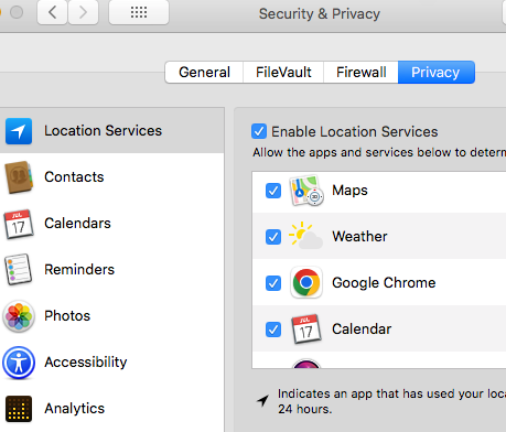

Both Macs are on the same network and wifi. As far as I know, Location Services is properly configured. The Privacy settings show everything enabled on the Mac Pro and my house even shows up in history under "Significant Locations". I've tried using a different Admin account with the same results. I am signed into iCloud and have "Find My" turned on.
At this point, given that my MacBook is having no trouble finding my location, I do not think it has anything to do with Apple's geolocation servers. Any ideas about where to look or what to try? I am suspecting perhaps some bad permissions someplace since that was one of my issues on the system restore.

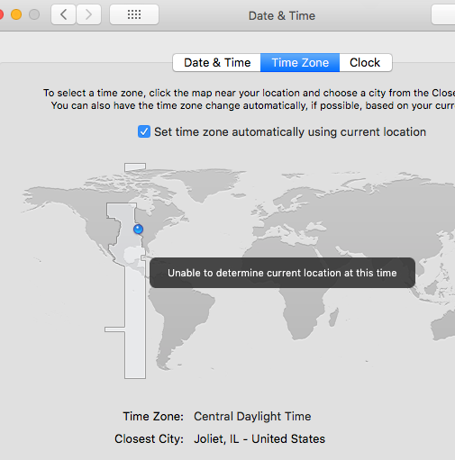

One other thing comes to mind — although, I figure you’ve tried many of the general troubleshooting steps by now — Apple advises ensuring the Time Zone is set correctly.

One other thing comes to mind — although, I figure you’ve tried many of the general troubleshooting steps by now — is the Time Zone set correctly on the affected Mac(s)?

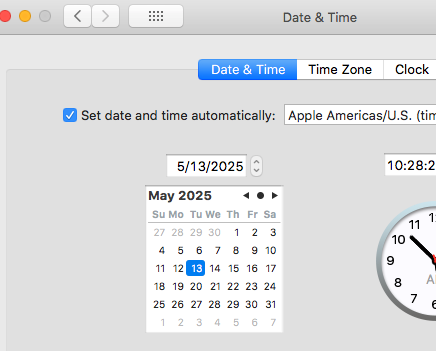

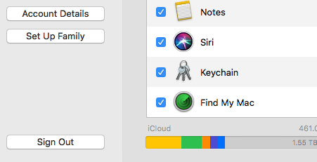

Yes. All the basic things are set on both machines. logged into iCloud, Find My is ON, Time Zone is correct, All Location Services are ON, everything has been toggled, rebooted ... etc. etc.
