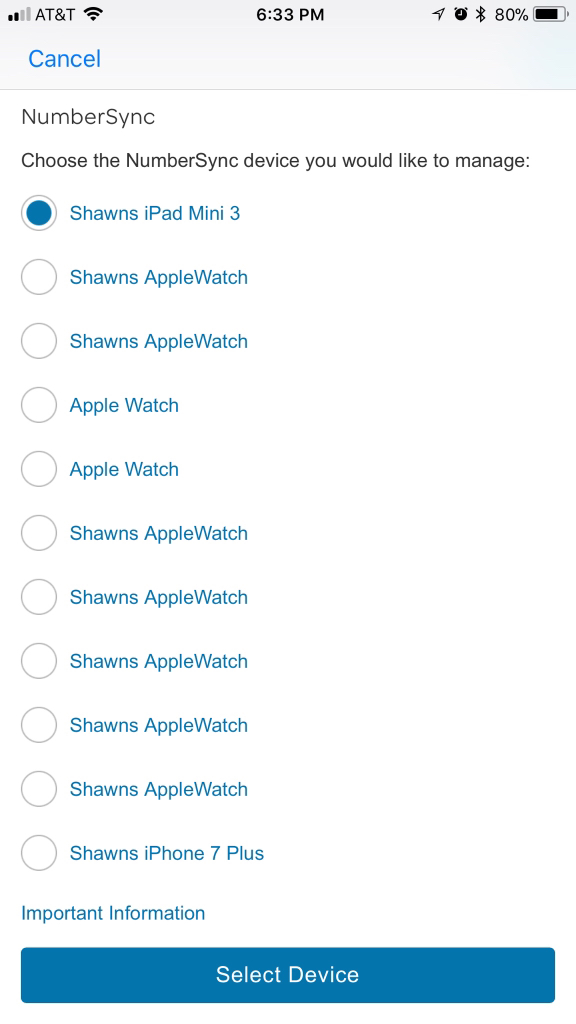

And, how do I get rid of all the NumberSync devices in the phone under WiFi calling > update emergency address > change NumberSync address?

I wanted to show you what I was referring to about the devices under change NumberSync address
