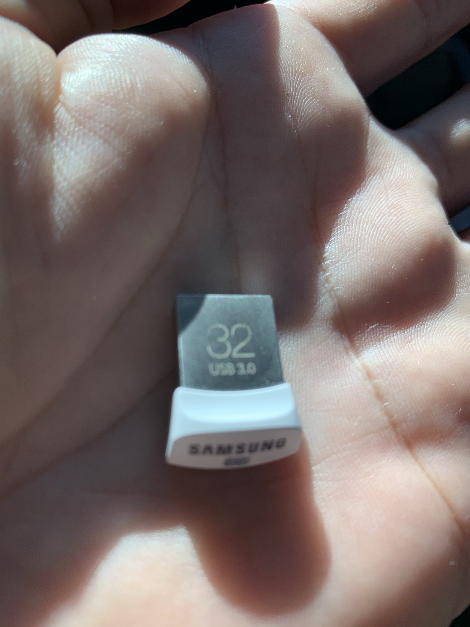

What brand of thumb-drive are you using?

I use a Samsung 32gb usb stick. Picture attached. Works on both CarPlay2air USB-A and Carlinkit USB-c
The light on the Carlinkit with the usb stick connected will be solid red when powered to the wall plug for a few seconds. It will then blink the red light on/off for around 20 seconds. Last the red light will stay solid at this point I let it sit for 2 minutes just to confirm it’s done.
If you previously had a firmware in the usb drive and sent it to the trash bin on your Pc. Make sure you empty the trash bin before ejecting the USB drive.
