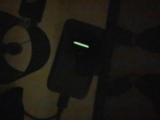

thanks for getting back to me. Absolutely no lights on this USB-C dongle. It had 2020.07.17.1459 and then I had put on the USB stick 2020.06.17 and then it said updating do not turn off and now shows nothing, no lights. I’ve tried in several cars, tried different USB-c cable.
as we speak I have a 2GB FAT32 (MBR formatted) USB stick in with 2020.06 firmware on. I am wondering if perhaps we can try find the .img of 2020.07.17.1459 to perhaps reinstall what it had before it was bricked.
It is currently connected to apple ac charger and no lights on the unit.
Hi guys, has anyone had ANY success getting a USB-C unit with no lights to ever turn on again, I’ve tried using power adapter and leaving in the car, still no luck :(
I'm afraid not but what I have noticed is if I plug my working one into a PC, it gets recognised as an iPhone after a few seconds. Might be worth checking to see if it still does that.
so a bit of an update I’ve taken my MacBook Pro charger 85W with USB-C to USB female adapter and now have a green light on the carplay unit. I plugged latest firmware in root directory .img file and then plugged it into power, not sure if green light is anything to go off? I tried it in the car again and no light. I tried it in normal iPhone charger, also no light, seems that it needs more amps. Any ideas what to do from here?

this is all I get when connected to the MacBook Pro Charger.
I loaded 29-07-2020 file
I think your only options at this point is to plug it into your car and leave plugged in there for few days, maybe it'll comeback to life like few others on here have done. Or if you purchased it from Amazon or eBay is to start the process of return/exchange. I would also try re-flashing it again with an iPad charger. Like others have said, too much current is not good for it, too little is not good either. iPad charger seems to be the goldilocks.
I’ve now got it to show the green light on an iPad charger so at least it’s showing some sort of life better than before. Maybe I should leave it plugged in overnight like this.
