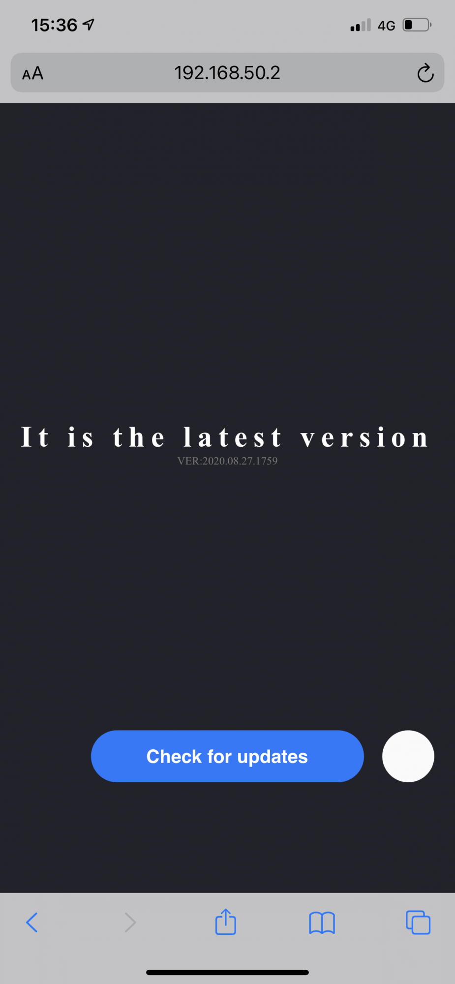

In the car.
With Dongle plugged in:
Start car
Let it boot up to CarPlay Screen
On phone/safari go to http://192.168.50.2/
Click update
Dongle will reboot when update is successful
Back to CarPlay
I do it in my garage. I do not disconnect from home wifi.

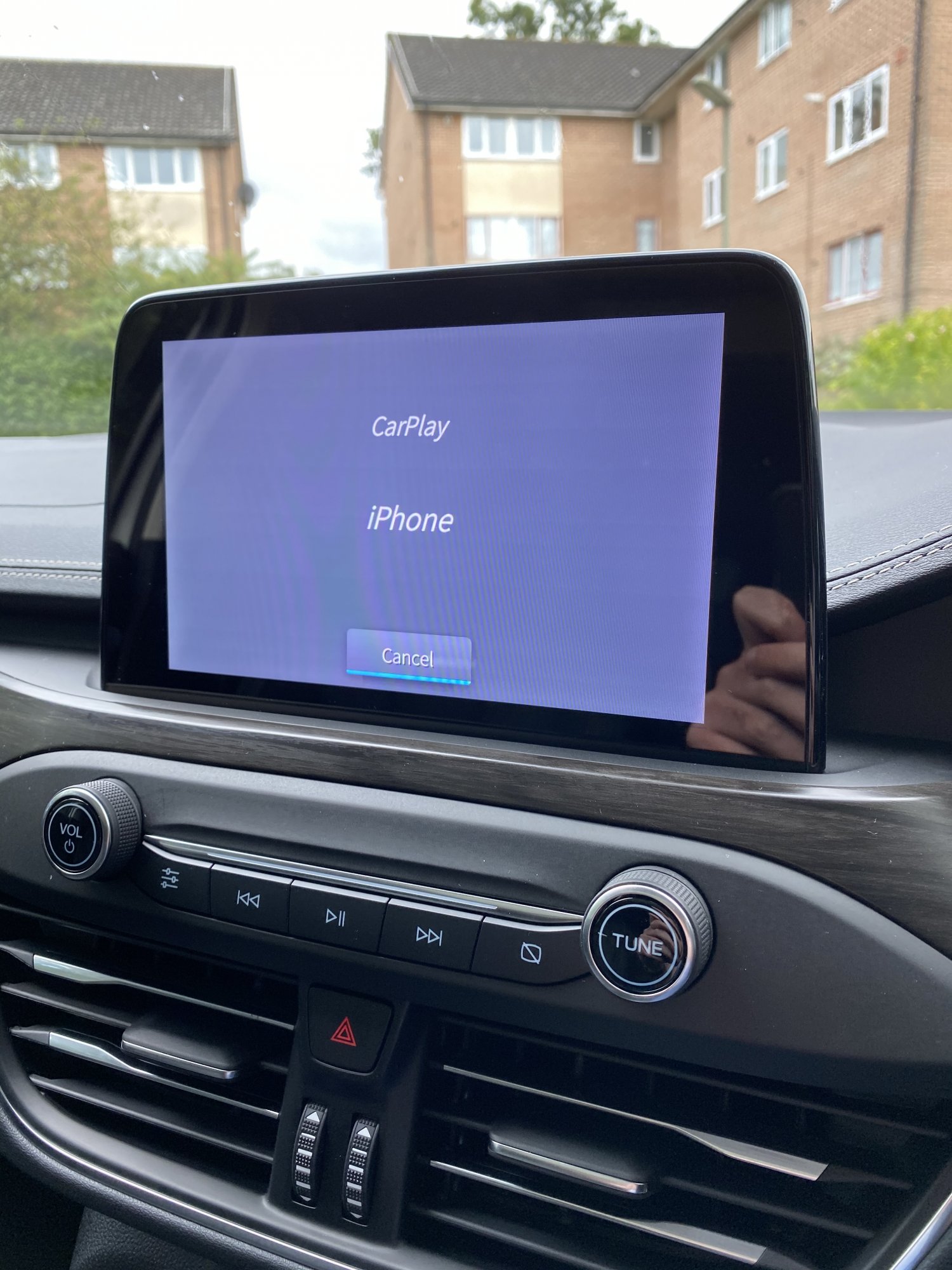

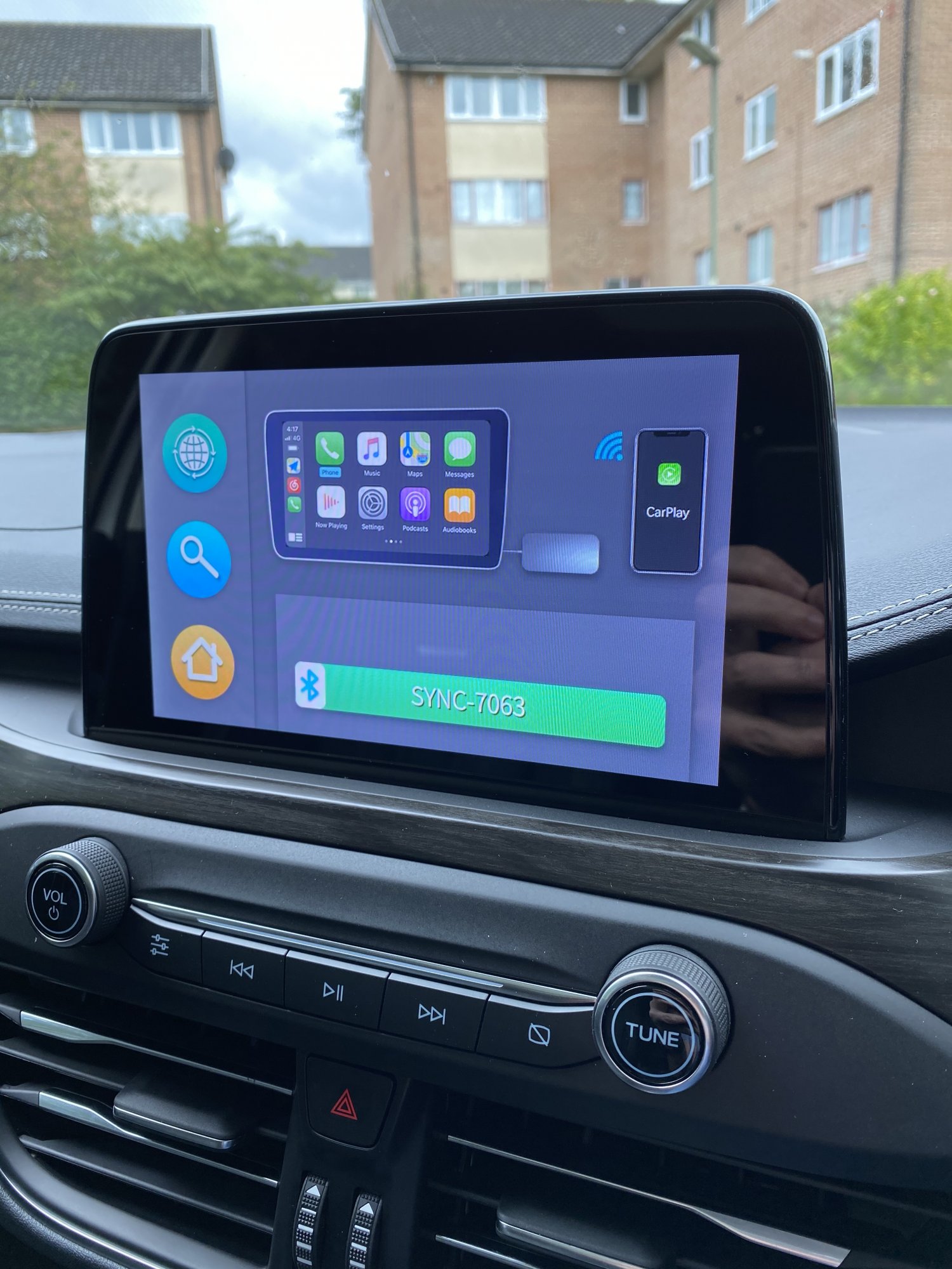

For some reason I always jump on these updates - I’m sure I’ll regret it one day! There’s a new UI when booting similar to the one on that new dongle, so their claim that their software is different seems rather suspect. That aside it does look much nicer IMO!
All else seems rather much the same.

View attachment 948297View attachment 948298View attachment 948299
I’ve been in contact with JoyeAuto and they said it was a different dongle, seems not after all!
I was trying to ask if support my car as others haven’t, they advertised Vauxhall 2016-2019, but then said might not work, and they haven’t tested it! So seems they are all the same and all claims are to be taken with a pinch of salt.
The extra screen maybe why the update file is a little bigger then.
Does the new screen stay on before connection for a while? What’s its point of being there?
