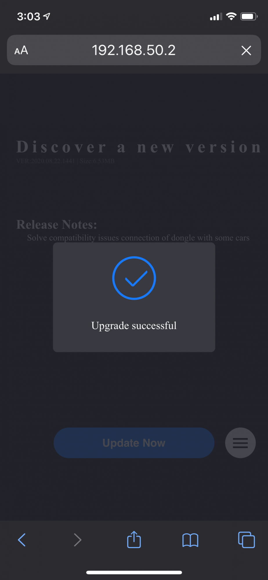

Was reading through the thread again and decided to check for OTA update. There was one available and applied it. After the unit did not restart and reconnect as it had prior. Then the problems began. LOL
Long story short, the Carlinkit 2.0 dongle wouldn't connect to the head unit or phone.
A manual update seemed necessary as the thing was unusable. Just flashed it manually and am giving it a few minutes on the supply before I unplug and try again in the car.
Manual update seemed to work. It allowed me to have CarPlay connect once. After that it never connected again, almost like the BT module in Carlinkit wasn't functional.
Gonna have to revert changes.

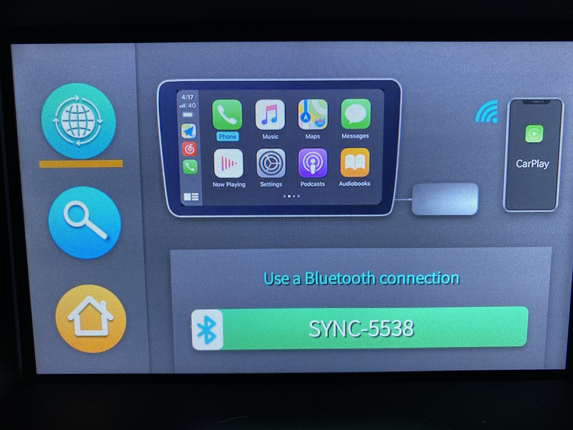

So much for a pattern Dano, I have the new interface on both my CarPlay2Air and USB-C Carlinkit devices.
Haha, well I got it on my USB-C Carlinkit. Haven't tried flashing my USB-A version yet.
For the record, the "Connecting to iPhone" screen looks almost identical to before. It's the initial screen before that that looks very different.
Not sure why some folks aren't seeing it.
Edit: I should add that as soon as I plugged the adapter in and started the car I was prompted to set up a new CarPlay connection. I think someone earlier in the thread said they had the same experience. Did those of you seeing the old interface have to do that?
Maybe it's car-specific. For the record my car uses Ford Sync 3.

By manual, I mean did you follow CP2A/CarLinkit's official directions of going into your bluetooth settings and selecting the BT network created by the adapter. Or did you do it the official Apple way of going into your CarPlay settings and selecting the Wireless CarPlay network shown in the list?
I'm wondering if doing it the CP2A/Carlinkit way somehow prevents the unit from being correctly configured on iPhones for wireless CarPlay and that is why it asked you to make a new connection.
Interesting. I guess this lends credence to the theory that maybe the variations people are seeing with the same firmware come down to their particular vehicle.
That theory would explain why I was one of very few people that had the headache of my gear shifter and climate controls being seen as controls devices for my Pioneer headunit by both the Carlinkit and CP2A devices until the 08.22 firmware.
Is it possible with new UI to change factory default Bluetooth name of USB dongle or it still gets name automatically based on car manufacturer (Ford cars get SYNC) and four digits randomly? I.e. SYNC-1234.
