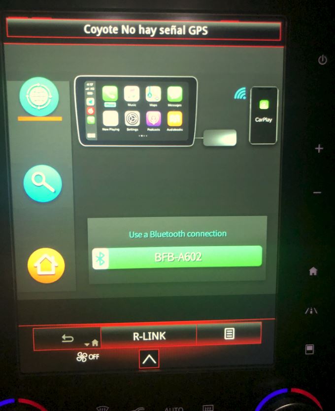

It's a nice touch, but I don't see the startup interface staying that way for long. It is very similar to the Pioneer demo screen that talks about CarPlay. They might take some crap for it.
I still haven't heard back from joyeauto on my rather pointed questions regarding that "new" wireless CarPlay adapter.
I’ve txt the same to them now about the same interface. Must all be the same in my opinion then.

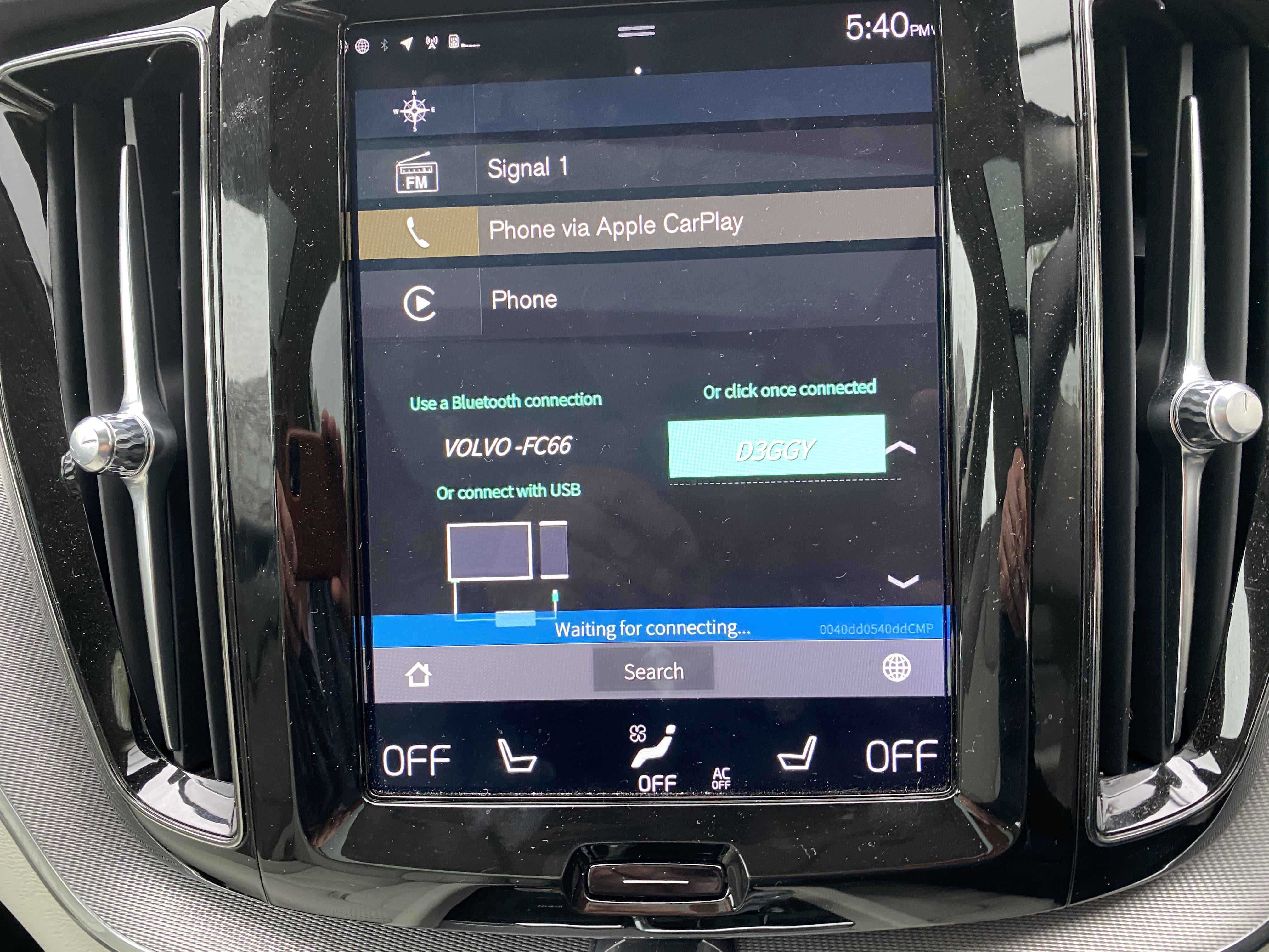

As mine has never worked, what is the startup screen for/do? I thought it just went from there straight to the CarPlay interface?
Right so I just did the USB update to the 08.28 image, interface was the same old one. Then I checked the OTA and it said I need to update but thats put me at the 08.22 version.
What am I missing? I was looking forward to a new interface.

The startup screen is for setting up your initial CarPlay connection.

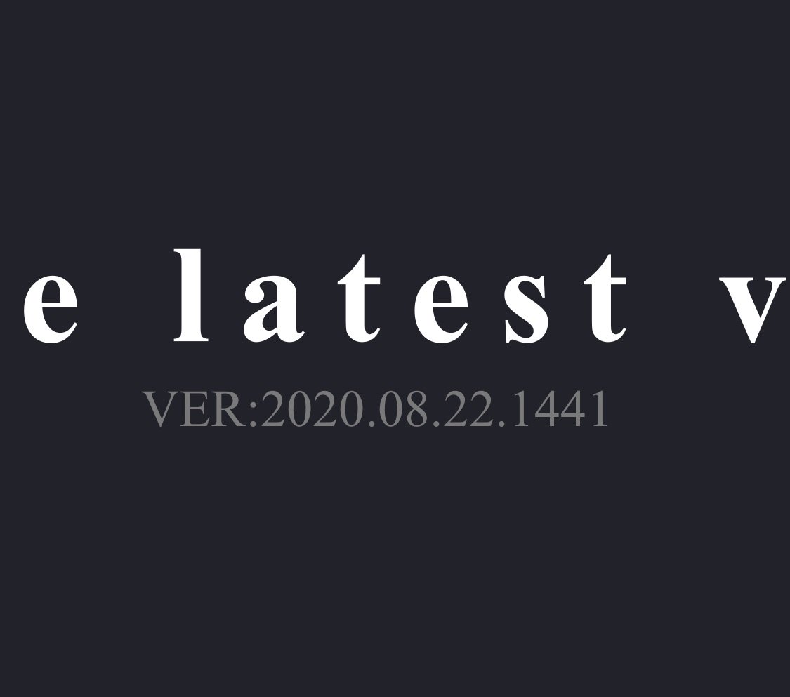

Same thing here. It booted up like a rocket ship so I couldn't even tell if it had a new interface. I am getting the upgrade to 8.22 as well, I was running 8.10 which I believe was the last OTA. Looks like 8.22 is now the latest OTA. I have no idea what I am running now. USB update with the 8.28 file seemed to work flawlessly. Doesn't make sense.

It looks like the screen where its actually connecting to your already-paired phone is the same/similar to before. The screen that is different is the one where it has timed out or doesn't have any active pairing (the one you showed in your photo).
I bet the OTA 08.22 version doesn't have the updated screen so that's why you are seeing the old one. Reflash the USB 08.27 version and turn off BT on your phone--then hopefully you'll see the new screen.

I have just installed the latest OTA (8/22) and my Volkswagen detected the adapter as a "new iphone", I supose they changed something in the code to provide better compatibiltity.

I reflashed using the zip file posted above. Same result - "Update Available to 8.22", so I did an OTA update to 8.22. I'll leave it be. I am sure the "new" interface is coming soon OTA.

Did you guys who are still seeing the old interface on 08.27 (not 08.22) try deleting the existing pairing and setting up as new? Maybe that's the only new screen, since it looks to be instructional in nature.
No, but I did shut off BT and I definitely did not have the new interface. Still wondering what FW was on it.
I did mine on a spare empty dongle with no pairings...
