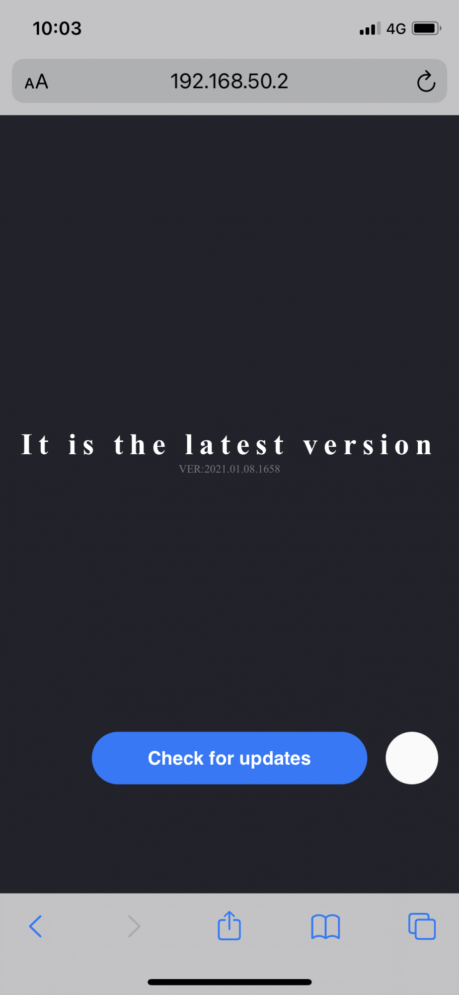

Got "Hardware error: Wi-Fi" after updating my old Carplay2air, just reflashing the update a second time worked, all worked directly on Carlinkit 2.0

2020 Toyota Rav4, with the new update 28.01.2021 my steering wheel buttons no longer work. Worked just fine on all prior updates.
After further use the buttons work fine in the Music app, but playing a podcast in Overcast doesn’t. I’ll probably just roll back to the December firmware since it didn’t have this issue.

I am bu the 28.01 build has broken this. Just trying to revert to 20.01 now
2021.01.28.1446 img is great. Many peoples are reported, and it works for my Mazda mx5 Japan model as well. Siri, Google map, Apple Music are perfect with my steering control switch. It made my day.
It’s broken on the Volvo XC60 not trying to find a version to revert to that works.

Sadly...same for me too! The August firmware works for the time being, but hopefully the fix this soon. I have an email thread going with CarlinKit around this issue.
Ford Everest Sync 3.4. Siri works perfectly. Hey siri and Voice button are ok. Cplay2air firmware version 2021.01.28. also works only once after flashing the firmware. through the next day. it doesn't work again (not show bluetooth and wifi hostname). I have to flash the firmware again. Removing the carplay device (remove phone) in the sync screen has no effect.
@D3ggy:
Thanks for the info. It is also broken for me on 2021-01-08. I was on FW 2020-08-04 for a long time--it worked well enough (although not 100%), but I updated to be able to turn background mode on so it doesn't show the Carlinkit interface at startup.
is there a version that still keeps the controls active for the Volvo. I installed 28.01 and its killed all the functions and I tried reverting to a Sept build I had but they no longer connect to the phone on the start up screen so I am guessing something changed on the BT firmware that the old software cant call on.
Have you found a version that will revert?
Not yet--will be testing this weekend.
On 2021-01-08, the steering wheel buttons still work for media control, but you can't see media info on dashboard and phone controls are not reliable. For the moment, I've set the car's driver display setting to "show no information in background".
