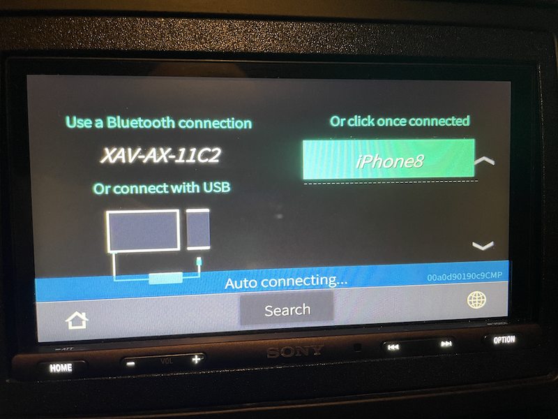

Thought so. I tried some older builds earlier today (sept) but they wouldn’t connect to the phone. I just got this screen.
Oh screen needs a dust.

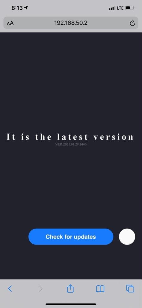

Does anyone know how or even if possible to check current version running? I assume there is a way from the 192.168.50.2 address? If there is an update available, it just shows the new version and not current version running.
Ok, I think I figured out how... http://192.168.50.2/cgi-bin/server.cgi?cmd=getversion
However, mine responded back it's running version 2020.10.19.0001??!!! This version doesn't even exist to the best of my knowledge? Any thoughts?

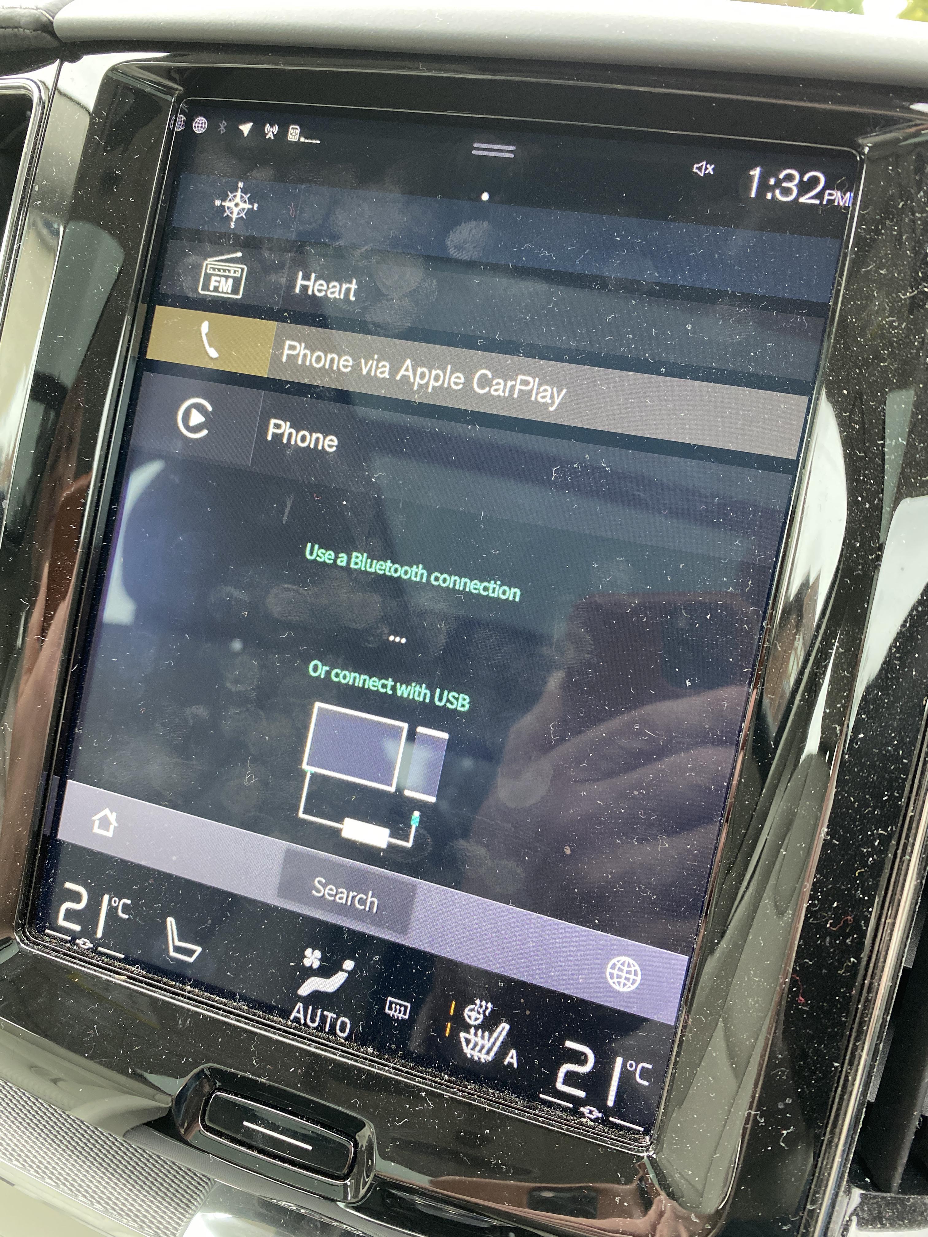

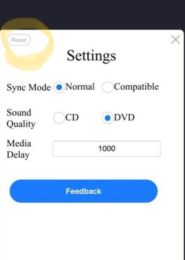

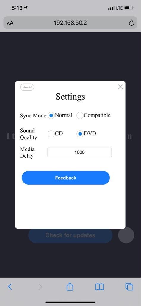

I'm not sure this is effective or not for your case. but when I tried several revision, BT connection show "..." instead of iPhone name, then I couldn't connect to adapter. so I made "Reset" on 192.168.50.2. then I could recover it.
I'm guessing some of BT setting are stored in adapter, and it might be conflict if we change firmware revision new to old.

I don't see most of the settings mentioned here.
All what I have in my settings are

How did you do this?
