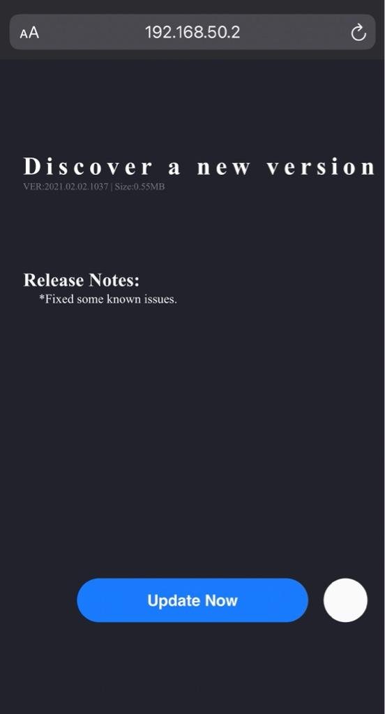

Had this on OTA today. 2021-02-02 but says file size of 0.55Mb?
