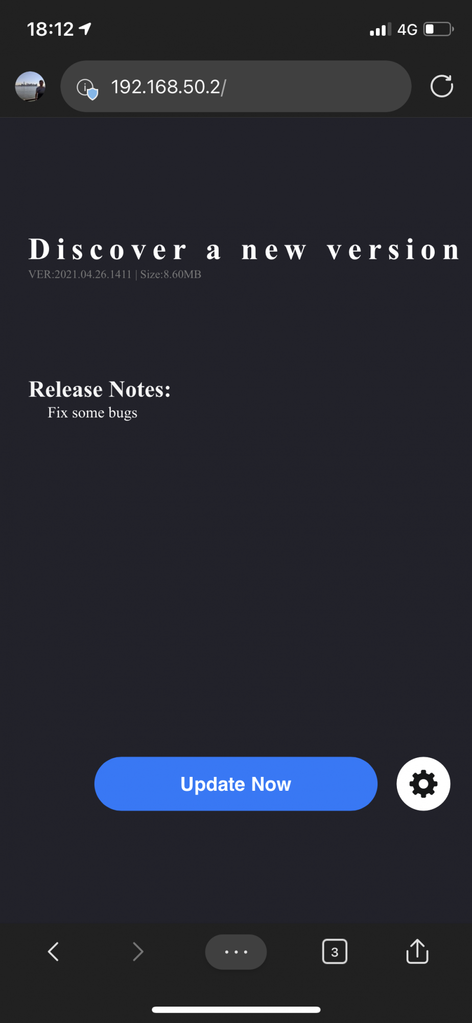

Today I received another OTA update: 2021.04.26.1411. It did not fix my reboot issue unfortunately.

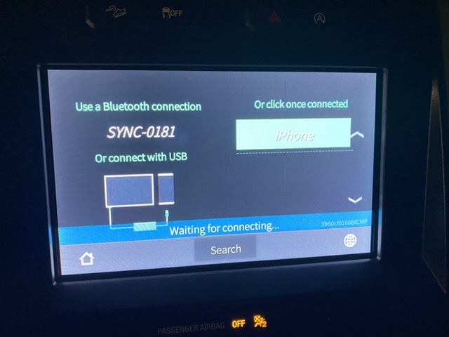

I have the Original Carplay2air adapter with the fixed USB A cable. I was on the newest update just before the one that has bricked my unit.. I am 99% sure it was the green UI
Hi,
Please find attached the firmware fix file for this issue. Please note this is only for Red UI versions.
I have the Original Carplay2air adapter with the fixed USB A cable. I was on the newest update just before the one that has bricked my unit.. I am 99% sure it was the green UI see the attached photo of my screen when it actually worked LOL. Thanks for your help if you have a quick instruction on what file needs to be on the flash drive and the proper procedure it would be much appreciated.

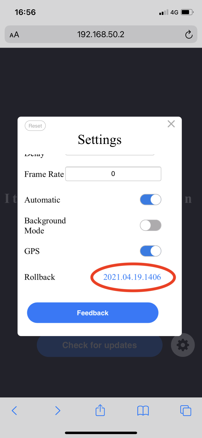

Is there a way to flash this 04.26 to a version with the Red UI? I don't care what color the UI is since I see that this one now has the newer "Background Mode" that was on the Red UI version... that's the way I tend to launch so it doesn't throw up the ugly splash screen. If I change the file name to include the word AUTOKIT do we know if that will work?
Does anyone know what Background mode means?
Yes... background mode means it skips showing you the ugly 'connecting' screen. It connects in the background and once it's connected, just launches to Apple CarPlay. It's a nice way to look more integrated.
