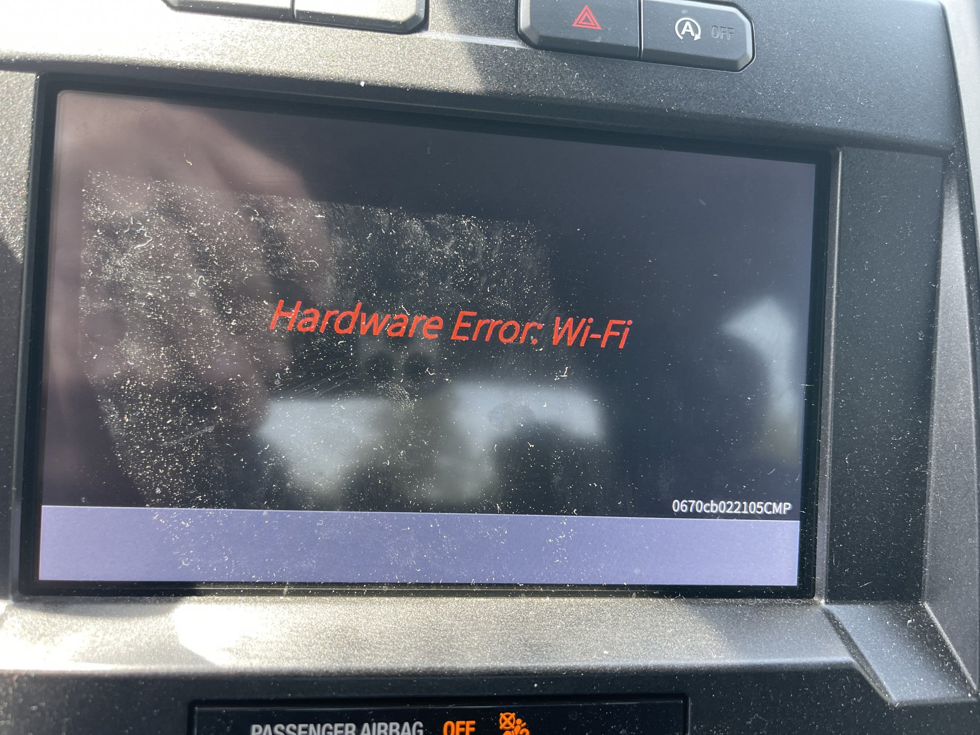

So yea I think the newest OTA update bricked my unit. Here is what I updated to and the result after I got the success prompt on the phone... Anyone?

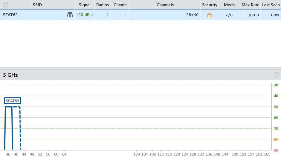

Here is some more info...
The access point spanned by the Carlinkit adapter only offers 802.11n 2x2 40MHz @ 300mbps:
It uses channel 36 which is UNII-1 and not the advertised 5.8GHz band (UNII-3). This should make any difference though.
Apple actually recommends 802.11ac VHT (using up to 80MHz wide channels resulting in 866mbps) and even mandates WMM. The Carlinkit 2.0 adapter offers neither despite the built-in Realtek WiFi chipset supporting both. I don't know whether it would make much of a difference since CarPlay is a point-to-point connection, not using a hell of a lot of bandwidth anyway. It might however bring down latency.​
Hypothetically, does this mean that one could set appropriate parameters somewhere in a .conf file in an unpacked image, repackage it and test the performance accordingly?
So I put all my findings into a separate review, see here. I will keep it up to date with latest findings and future firmware improvements/regressions.

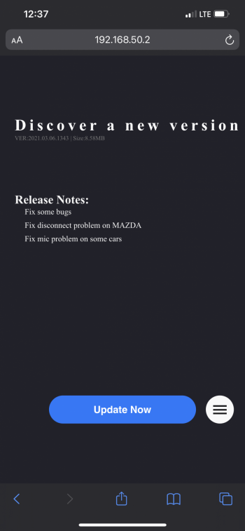

Have an issue where the dongle will disconnect after 30 seconds or so of being connected. Have to unplug and replug to get it to work. Updated to the latest firmware when I got it in December-ish - is there a fix for this in any newer firmware? Car is a 2019 Mercedes A Class. Thanks!
All Mazdass used to have that exact same issue, For Mazdas, it was fixed in the 2021.01.28 updates. Current is 2021.03.06 and that works very nicely, for Mazdas. Maybe for yours...
Hi, I have a 2020 Mercedes A Class, I had this same issue initially, the custom 02.02 firmware has fixed it for me. I tried the 03.06 too but find the 02.02 seems to be the most stable for Mercedes. I find the device also boot up faster with the custom firmware too.
Cheers
Reactions: cambookpro

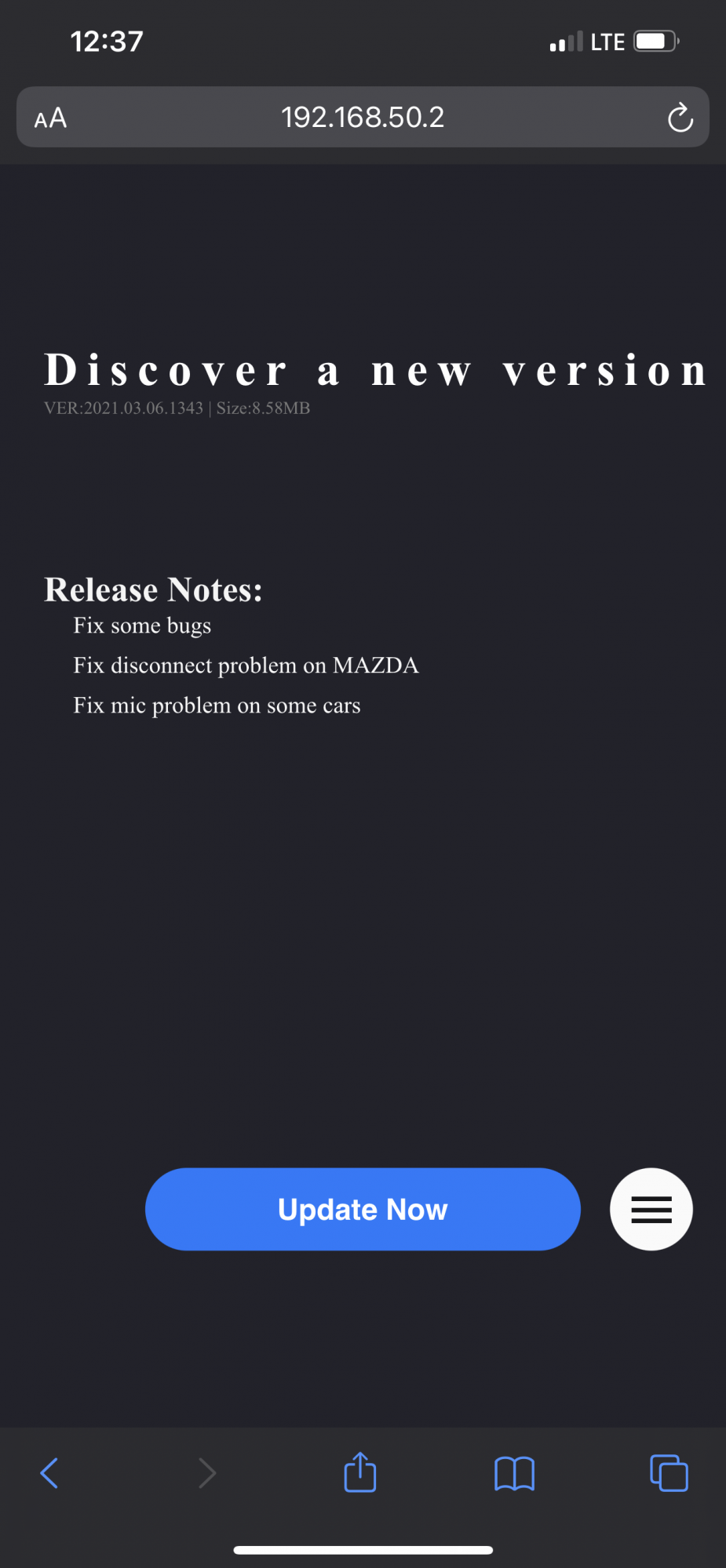

Constantly getting an 'Update failed' error when trying to go to 03.06 firmware... any ideas? :(
I'm not sure why "Update failed" was happened. but it seems you have updated via OTA. so how about USB drive updating ? See #1 message.
