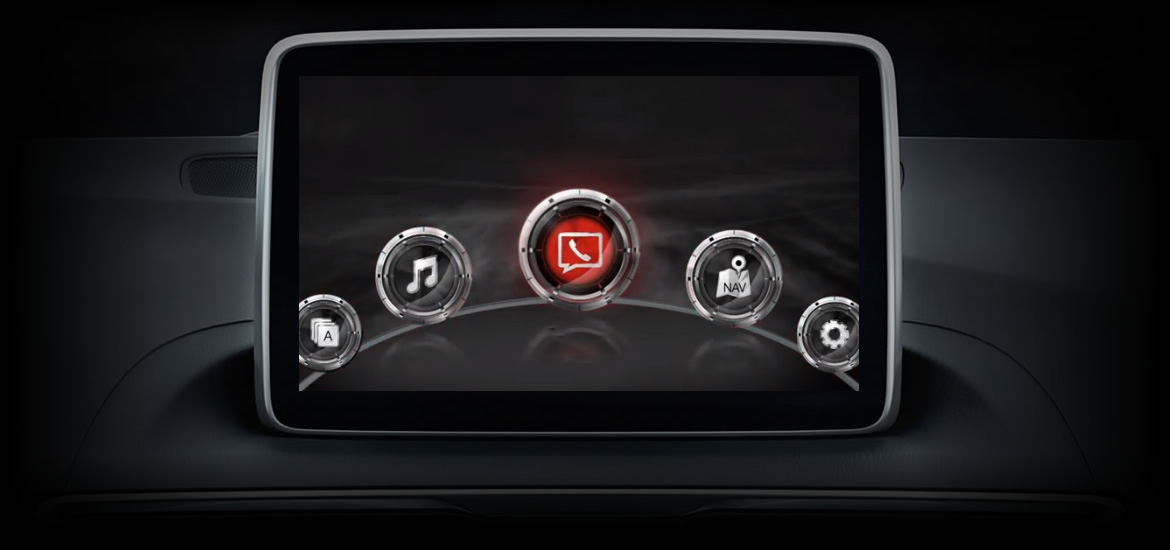

What year is your CX-5? Curious if it has the older infotainment like my 2017 3..
It’s 2022, so it has the newer system. With my previous older CX-5 that ran the old version of the Mazda Infotainment, I could actually enable wireless CarPlay through the car directly. I made the mistake of updating it once thinking it would improve it and it just removed that option altogether 💀 my next Mazda in 3 years will have it for sure, since Mazda has been introducing wireless CarPlay on their CX 30/50/90 series.

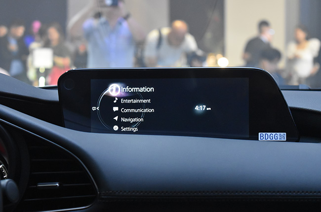

I've tried several new generations of wireless Carplay devices trying to improve on the 35 second wireless Carplay start-up time on my 2019 Mazda MX-5 (Miata). Do you know the version number of the Mazda entertainment system firmware you are running? I know that newer versions exist than what I am using (70.00.352), and I have wondered if a newer version is what I need to get a better start-up time.
Mine runs something else altogether. The 70.00 is what I had in my previous model.
^ you have this version, I assume?
They’re running this one nowadays:
As to your question, it’s never been the fastest system boot up across the cars I’ve owned, but this newer version is faster to do so by far than my previous model, and using this adapter, as soon as I press OK to get rid of the initial disclaimer pop up when the car turns on, the wireless CarPlay kicks in. 3-5 seconds at most.
