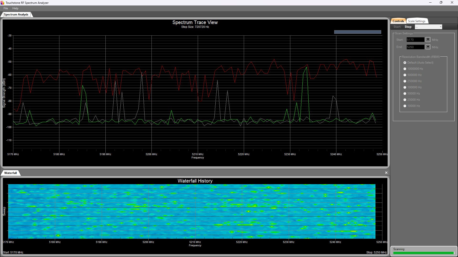

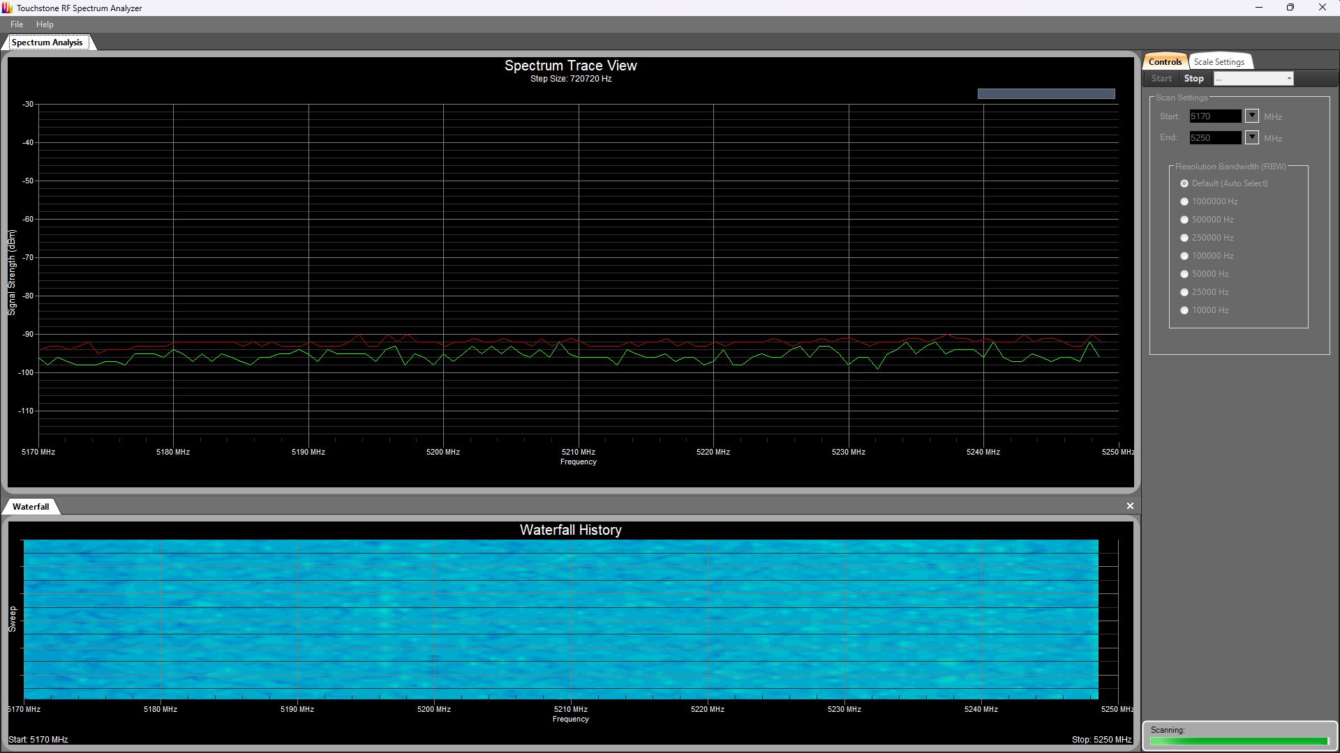

I now compared UNII-1 (5.2 GHz) to UNII-3 (5.8 GHz) with respect to background noise and transmit power of the iPhone with a signal analyzer.
Background noise CH #42[36] (5.170-5.250 MHz)
Background noise CH #155[149] (5.735-5.815 MHz)
CarPlay with iPhone 13 Pro CH #42[36] (5.170-5.250 MHz)
CarPlay with iPhone 13 Pro CH #155[149] (5.735-5.815 MHz)
So you can clearly see that noise level is higher on UNII-3 while iPhone transmits with a lesser power. So it is clearly more easily interfered with. Then on the other hand, UNII-3 may be less crowded...
