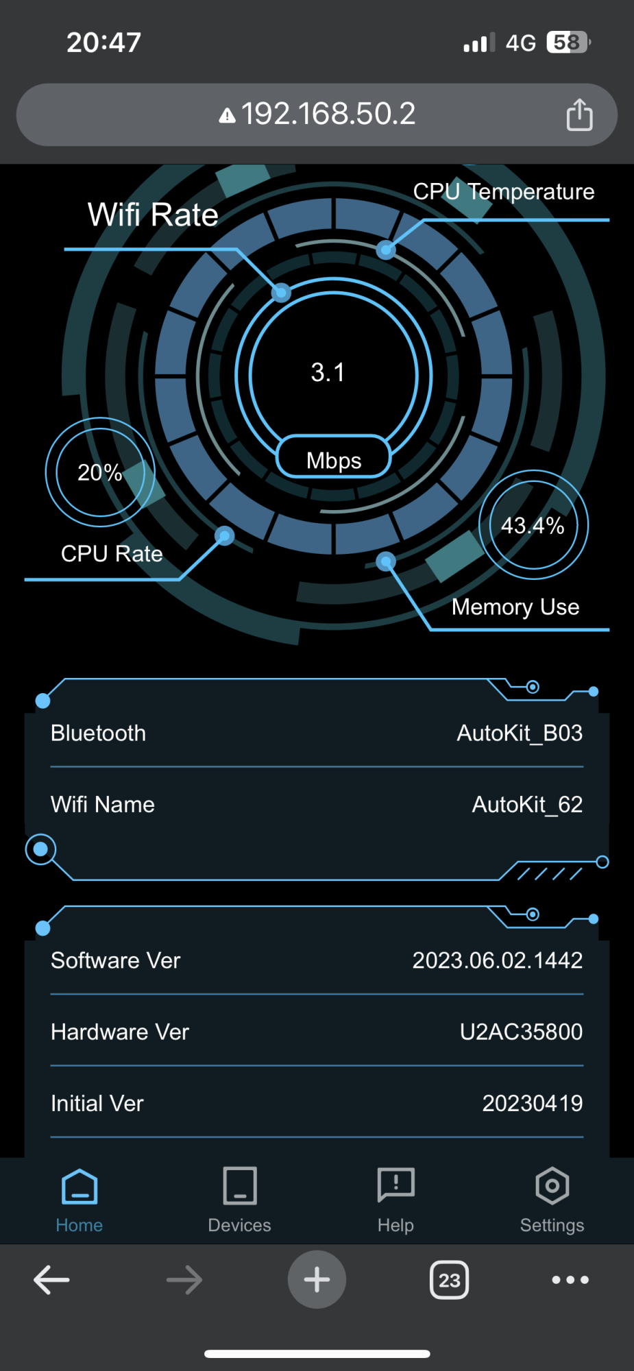

Can I ask what you use to get these wifi details?

The Wi-Fi details I shared were from my Mac running Wi-Fi Explorer.
ref: https://apps.apple.com/us/app/wifi-explorer/id494803304?mt=12
On Windows, you can get similar results using here: Acrylic Wi-Fi Analyzer, advanced analysis and troubleshooting (acrylicwifi.com)
You could, on your iPhone try running a ping to the 192.168.50.2 address. That would tell you if the cutout you're observing is due to wireless connection, or something else. I use Network Analyzer Pro on the App Store (apple.com) on my iPhone to troubleshoot. When I was seeing the connectivity issues with wireless on my v3 and v5, I could see the ping timeout/drop at the exact same time. Switching the channels seems to have helped quite a bit for me. YMMV depending on area and other interference.
If ping doesn't drop, and you're seeing it freeze... It's likely something software related, or hardware between your HU and the device. It's unlikely that the Wi-Fi channel change would fix it if ping/connectivity shows stable. Though, never hurts to test. 🙂

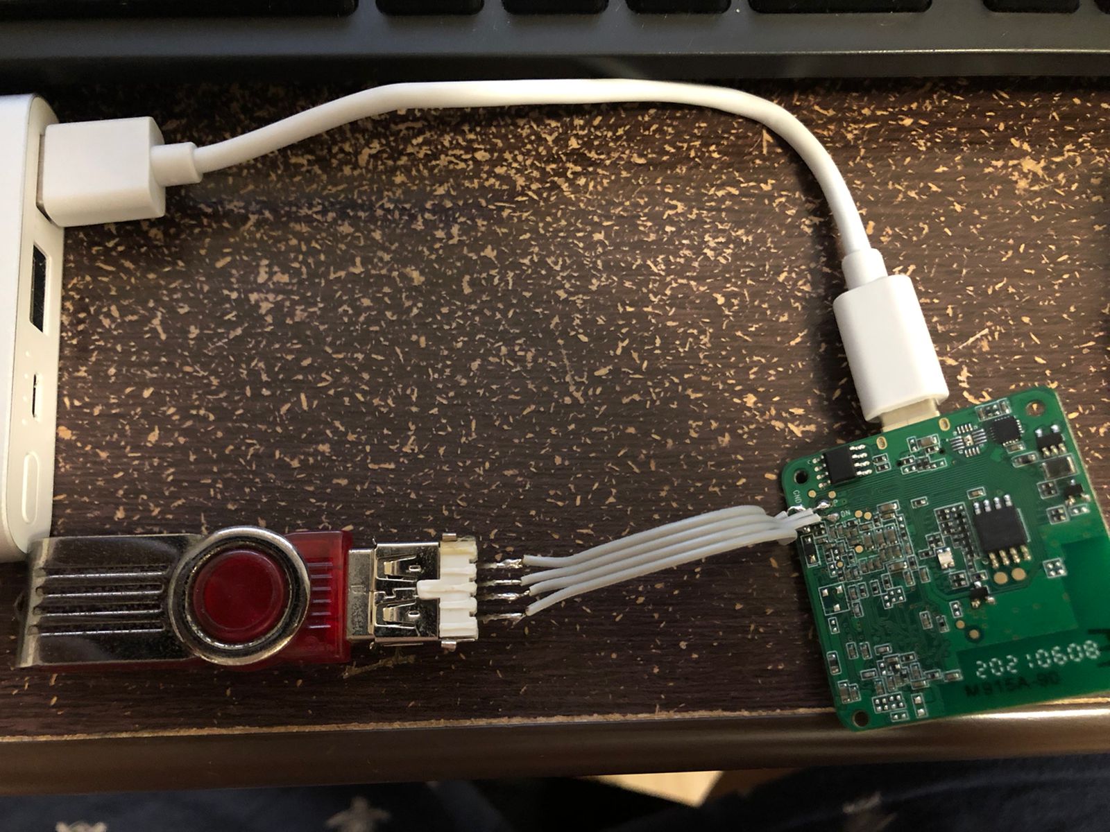

Does anyone use Carlinkit Mini? I tried to update the firmware and the device stopped responding. It doesnt even turn on the LEDs! Since I'm an electrical engineer, I opened the device and found an USB interface. Then, I soldered an USB A female connector and I tried to upload a rollback firmware. I didn't work tho.
Does anyone have any suggestions? Thank you!
Hi guys,
Same happen to me yesterday, did not know that ordinary update will brick your device - Hardware Error: Wi-Fi BT. Device: CPC200-MINI (U2W Mini).
Does anyone somehow managed to rollback the firmware or update to the latest ?
Official support replied: "...There's no way to update the firmware on this one. ...". Bought it on AliExpress 2 years ago, no way to reach the seller for customer service.
Maybe there is the way to somehow to connect to this device via "SSH" and pass the firmware file and manually trigger update... or... solder USB port (with interface) ?

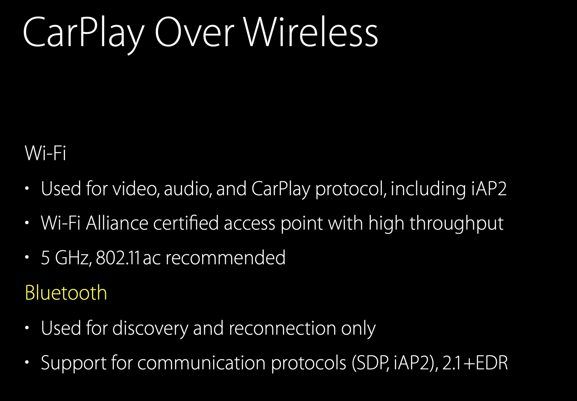

I could be mistaken... But I believe the Bluetooth is only used to be like "Hey, iPhone... Connect to CarPlay via Wi-Fi now that you're close enough, or reconnect if you disconnected." I don't think any data or communication is sent over the Bluetooth Connection once CarPlay is connected. I am under the impression that it's all handled over Wi-Fi directly. So, the Bluetooth version doesn't matter as much. Basically, the Bluetooth connection is only there to send the iPhone information on how to connect to CarPlay over WiFi, and to nudge the iPhone to connect to CarPlay if it isn't already.
Found the documentation backing up my logic and claim (attached PDF if URL changes):
Reference the page:
Reference the page:
