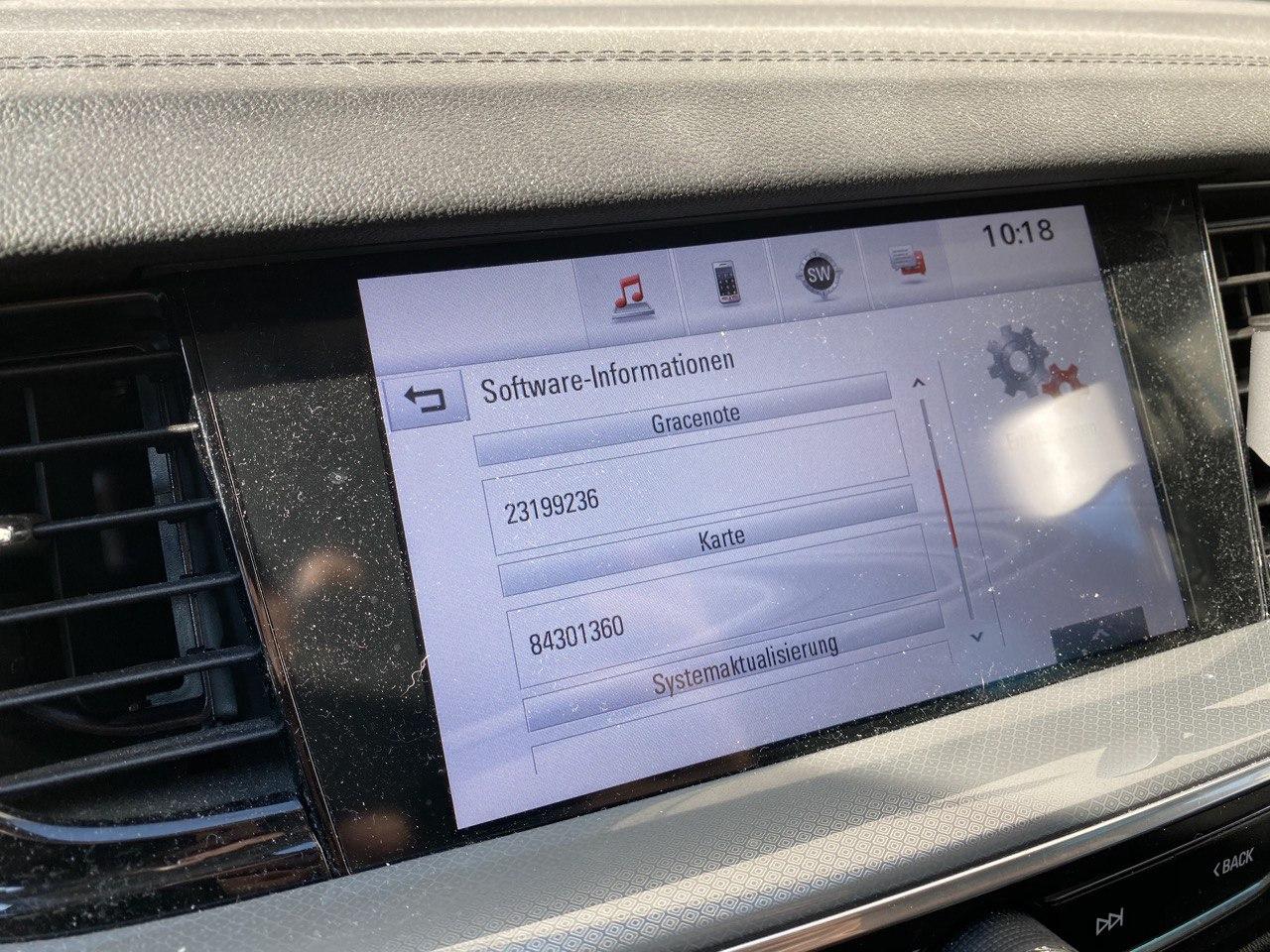

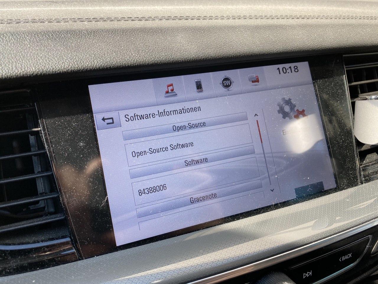

@MrMister111
In my car it seems to be a Navi 900 IntelliLink head unit.
Software version is in my post above.

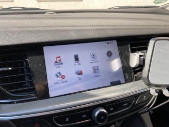

That’s what mine is, a Navi 900 Intellilink, looks exactly like that YT video, and your CarPlay dongle for wireless works?
Mine does have OnStar and does have WiFi though, strangely I switch off WiFi on the car, but iPhone can still “see” it in the list, so I’m not sure why it’s still finding when it’s supposed to be off.
Could you go into your car settings and take a pic of your versions, I’ll check mine.

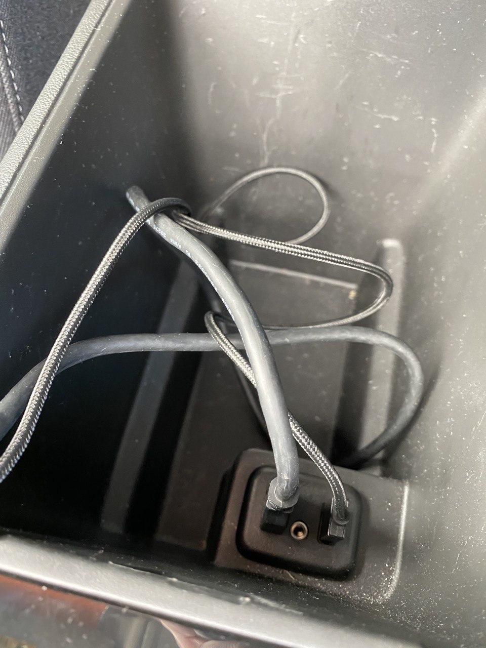

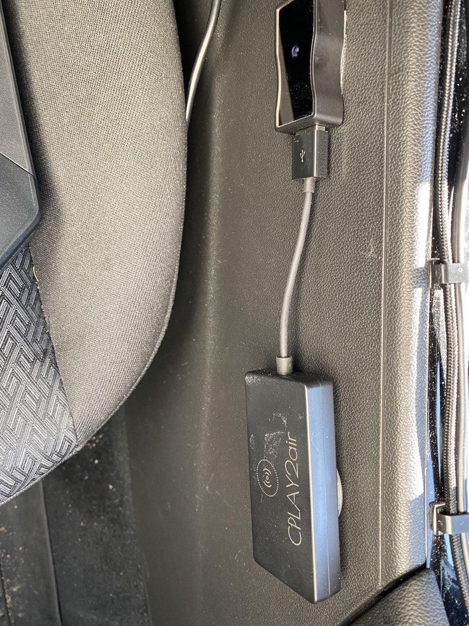

I only plugged it in and that was all I´ve done.
No, after 2020-03-06 update everything was fine. Only the startup problem after locking the car is present but i think it´s a problem with the usb voltage supply of the car :/
I attached you serveral photos of the headunit and the setup. Hope it helps 😉
