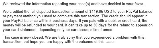

Well, that was easy, literally put in a PayPal dispute yesterday:
