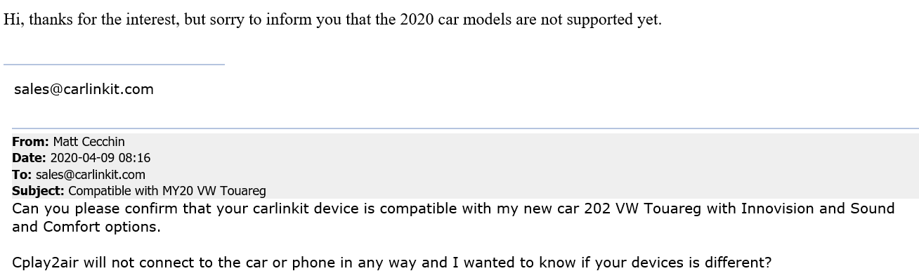

Cplay2air are rubbish, didn’t connect to MY20 VW Touareg. No technical support, no return policy. The organisation is dishonest as any poor review is not posted on their site.

Agree seems like I’m being harsh however this after weeks of frustration with responses being endless questions. I have even sent them a video of doing the process. I feel like they have dragged it out to exclude a return as a refund. Any website that won’t post all reviews except 5 star I feel has something to hide (Cplay2air.com)
Ok let’s trouble shoot. Its a MY20 Touareg with inovision and sound and comfort as the two options.
I have tried both with and without having the car and phone previously paired with the head unit. I have tried having my wifi connected to the house and not connected. I have tried plugging the dongle in before and after starting the ignition.
every time gives me the some result. Red light on dongle, no change to head unit in both CarPlay or Bluetooth screens. No change to phone in anyway
It’s as if the only thing the dongle is doing is showing a red light.
happy to try and upgrade however with the instructions provided and what I could find online I thought the dongle had to be connected via Bluetooth or wifi to a phone for that to happen. I can’t get it to connect with anything. any helps greatly appreciated

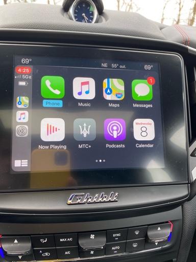

Got mine up and running in minutes. Add 2017 Maserati Ghibli to the list. Of course I’ll have to use it longer than 15 minutes to report bugs or anomalies. Boot up time is about 10 seconds. Audio quality sounds perfect just like it did when wired, maybe better. Maybe a half second lag changing songs with steering wheel controls. Touch display is just as responsive as wired. Phone calls crystal clear. The only thing I noticed is that when I changed songs when wired, the song would display on my center display for a second and then go back to the speedo. Doesn’t do this wireless and I remember reading about this in the thread. I can manually display it there so it’s reading it, but really not a big deal.

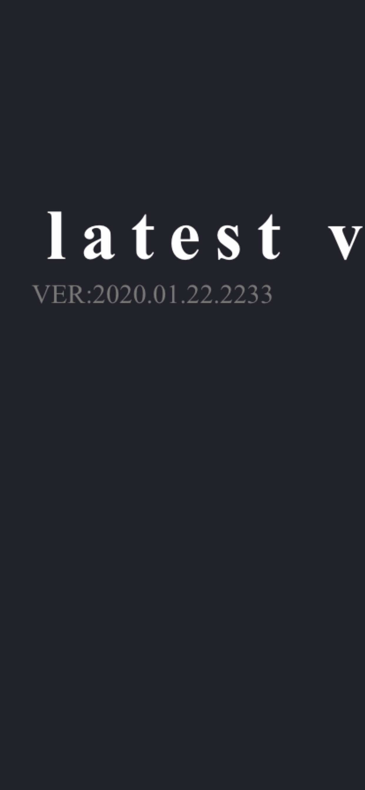

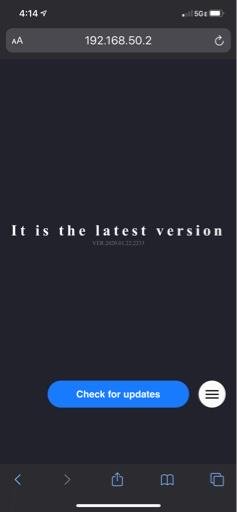

I did check for an update and it updated. I assume this is the latest release, see pic. Am I running the latest 2.0 official firmware?

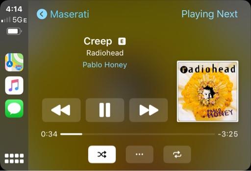

I understand you got this one from Amazon but glad you finally got one device after that waiting. Your experience is similar to mine with CarPlay2Air, a little lag, clear phone calls, same update process, same software version. But, I do get the song changes in my instrument cluster on wireless. Enjoy ! 🙂
Thanks. I did think the song changes in the instrument cluster was solved. Must be car by car. I could try the March update that must be done via USB, but I think I’ll leave well enough alone at the moment.

Thanks mate Carplay2air have now gotten back to me saying that my car is NOT supported so I can return the item however can not get the transport refunded and will be charged a $25 packing fee...
I disputed it with PayPal and the ruled in my favor super quick. My guess is that they have had many complaints about this merchant. I was surprised it was so quick as they could have said to wait to see if it arrives. Supposedly it did ship, but showed no movement for three weeks. It's bull they are charging you a fee.
Looks like MY2020 models are not supported as yet. What do you think, hold on to the device and hope the USB update works when it happens down the track or look for a refund via paypal?
