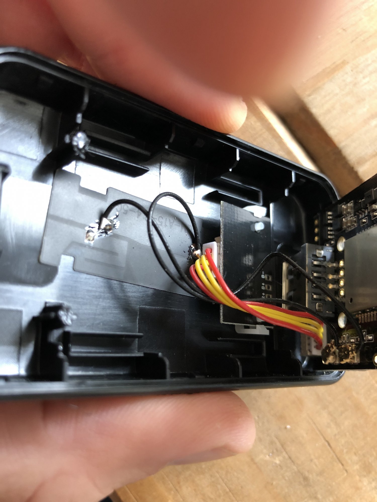

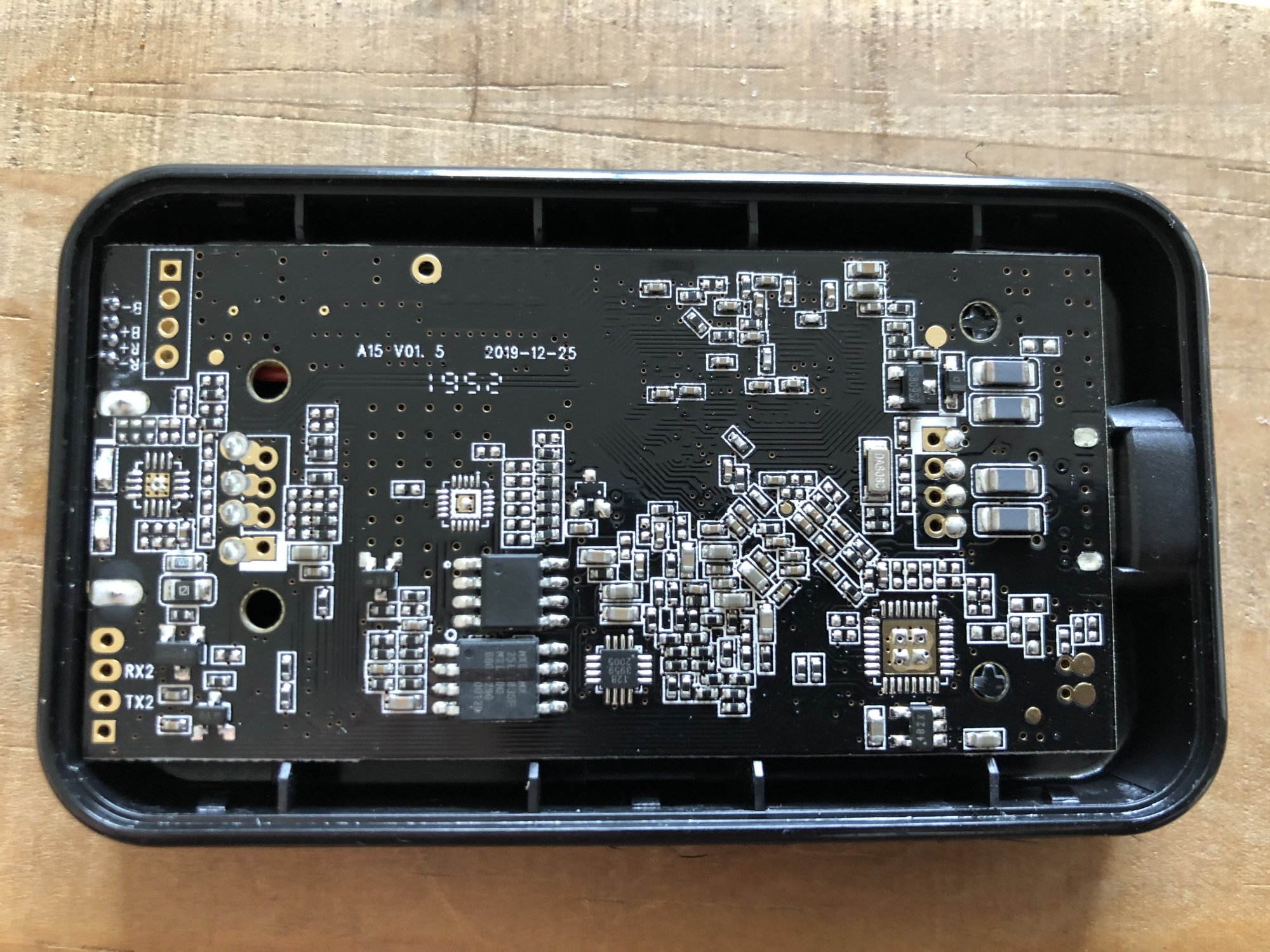

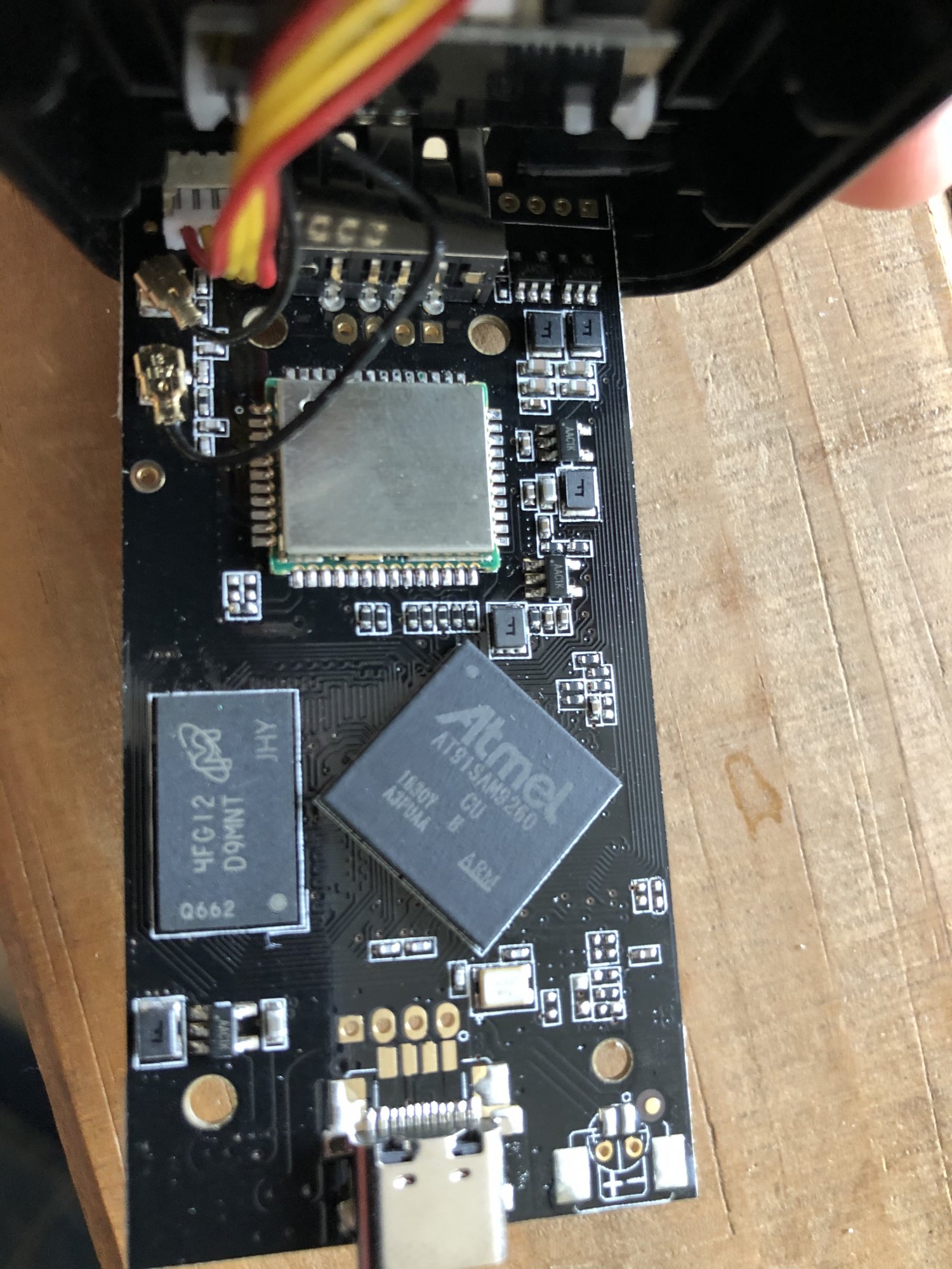

I haven't had a v1 to compare to but I have opened it up to see what the processors are.
Photos bel
ow....
[automerge]1589744245[/automerge]
Thanks for the Pics Shadowswan. Larry i meant no offense. There are 92 pages of information here. I was trying to help keep the information factually accurate (for all of our benefits because we are supporting each other more then vendor is supporting us). OTA updates check against the same download directories others have used to to manually download updates including the March ones. No one seems to know why they have "lost" or "pulled" March updates. I believe if I recall in this thread there had been February ones too. Maybe they had a server die or a software engineer get sic. We really do not know what happened. The software all literally has the exact same file name, only the download link by release date is different (once downloaded) you have to keep the firmware in different named by date folders to tell them apart unless you actually load the firmware. In fact that was what happened to BookemDano. He thought he had firmware from March 7 and when we both loaded it we realized it was March 4.
