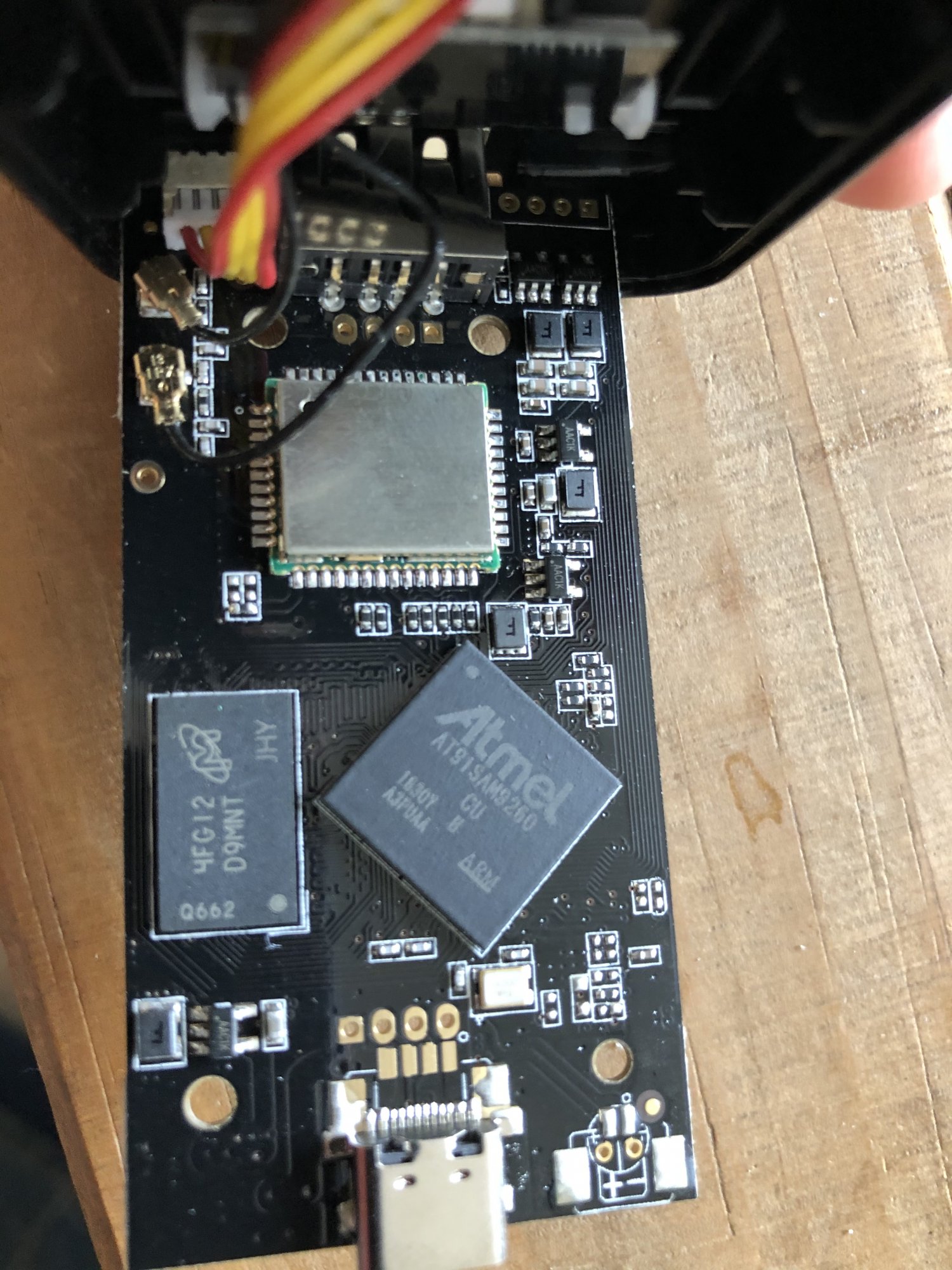

At the moment on the board all I can see is the arm processor and the RAM next to it. There is obviously another sensitive component under the shielding which is intriguing too.

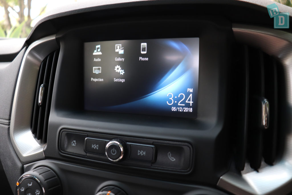

I didn’t know there are any cars from GM with CarPlay and no gps, in part because I’ve never seen a GM car with CarPlay that also didn’t have nav. What model is it they sell that way?
My Chevy has Carplay and no nav. But I dunno if it has GPS builtIN or not.

I haven't had a v1 to compare to but I have opened it up to see what the processors are.
Photos below....
[automerge]1589744245[/automerge]
The Carlinkit USB-C dongle uses the same physical chipset as the older CP2A/Carlinkit dongle. Thanks to @chill991 and @shadowswan for opening up their units and posting the info. Aside from switching to USB-C and a shiny new case, the changes are primarily in the firmware not the hardware - although they might have also refined the circuit board design.

The shielded component you saw is the wifi & Bluetooth chipset.
