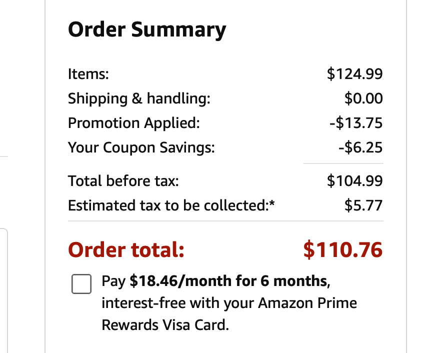

USB-C version for $105
Not sure what's going on? There is a 5% discount coupon, but total of $20 off at checkout. A long wait for delivery.
Maybe because it takes 2 months to ship here? I know, I bought one drone Amazon. 6 weeks.
Yeah the ones with long ship times straight from China are cheaper since the beginning because people do not like to wait. I know some have paid for faster shipping.
