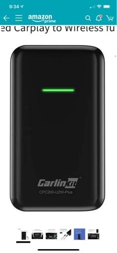

Thanks. My heart wanted it to work but my head told me it wouldn’t. BTW, is there an LED on this model? I had nothing at all light up for me to even ensure there was power.
Yes, it’s on the front. It’s pretty dim.
