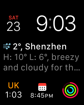

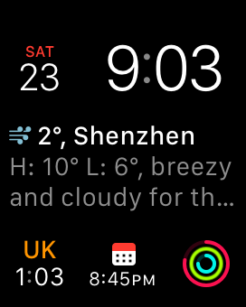

What should this one say? 🙂
That's either "for the hour" or "for the day". I'd never seen dual conditions come up like that back during the summer/fall when the complication was being built, maybe those really only come up during the winter. I'll make a note to filter those for length in the future. Thanks!

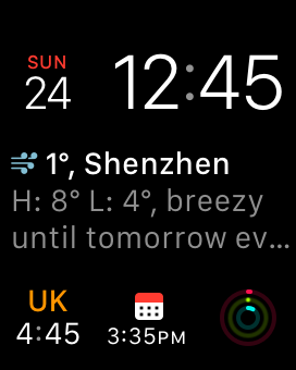

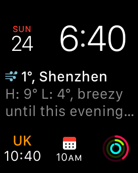

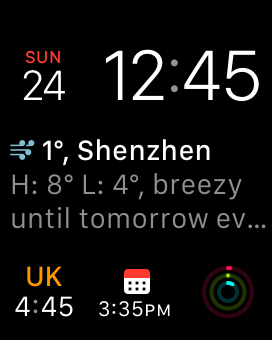

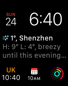

Another oddity, different conditions this time but same result.
This one has two problems. Until tomorrow evening doesn't quite fit and also... It's quarter past midnight. Tomorrow evening would be continuing conditions for roughly 42 hours?
Are the ellipses intended to make the forecast more mysterious, or is this another bug 🙂
I'm enjoying this beta testing. I'll be upset when I'm back in school and have to revert to the small complication. Although I'm sure when that happens (cough one month cough) I'll have that lovely new conditions and precipitation complication to test 😉
Reactions: dooku77
I think the issue is that, for some reason, the hourly condition text from forecast.io is a lot wordier for China than it is for other countries. Looking at the forecasts right now for a couple different cities in China, a lot of them have dual conditions (i.e. "rainy and breezy" or "overcast and breezy"), so I'll just have to filter them a bit better in the next update.

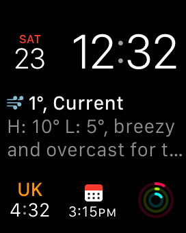

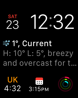

updated about an hour ago, complication was still showing "current loc..." a second ago without asterisks. where are the asterisks meant to be, at the start or the end?
Asterisks are at the end, but it should show up as "Unk***" if the asterisks are going to show up. The data was probably just cached from the update before you installed the latest beta - next time, you can open the main Watch app to force the complication to refresh. "Current" and "Current Location" shouldn't show up anymore on the complication.
