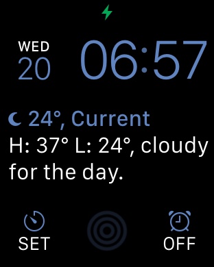

Just got this screen. Now this is rare, as the newest updated beta has been working nearly flawlessly since you fixed the last location issue. Just wanted to see if this "current" location name is somewhat normal and could show from time to time. I guarantee if I look again in a little bit, it will be fixed on its own.
I've gotten that one, as well as "unknown", once or twice since the latest update. Working on tracking it down!
